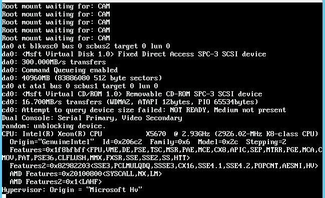

      My current issue is as follow. I can install PFSense just fine. It boots, I can get through the setup process and get to the web interface no issue. Even internet will function etc... HOWEVER, the 2nd I go to restore my config from the physical system to the virtual one. I run into all kinds of problems. For starters because the Eth labeling is different between the virtual system and the physical system, I can't restore interfaces or DHCP server settings. If I do, the whole system fails to obtain internet. Normally what you would do is just go to CLI and manually reassign the NICs to the proper interfaces numbers. Again, however, when I reboot PFSense it will get about half way loaded and stop at right after it shows CPU, Memory etc... and it gets to "Hyervisor: Origin = "Microsoft Hv"" then it just freezes. I'm unable to even get to the spot to change the interfaces... in the past versions of PFSense if it dedicated hardware change for interfaces happens, it would just prompt you in the CLI to assign new ones. Not here. It just freezes and doesnt load to the point to where I can even do that. Again this only happens when I try to restore my configuration.
      I tried to manually restore all sections expect for DHCP Server and Interfaces, however, the same thing occurs, internet drops out and on restart, it freezes again at "Hyervisor: Origin = "Microsoft Hv"".

      Image of the issue below:

          Not trying to sound like an ass. But as I described above. Installing it with a fresh installation of PFSense without restoring the config files works just fine. Indicating it is not a hardware\compatibility issue. What I suspect is the problem is something with configure file trying to restore drivers or something its restoring that is conflicting with the config because the interface types are different then the original config backup target source.
          But just for the sake of it. Here is the info:
          Windows Server 2012 R2
          Gen1
          PFSense 2.6.0
          PFSense 2.6.0
          Originally on the mini PC it was using the most up to date PFSense plus version which I believe is 23.09. Used Community edition PFSense 2.6.0 on the VM with the PFSense Plus config. Doesnt work. Used the same PFSense Plus config on the physical box, again restoring to PFSense 2.6.0 and it works. Only issue is with the Hyervisor side of things.
