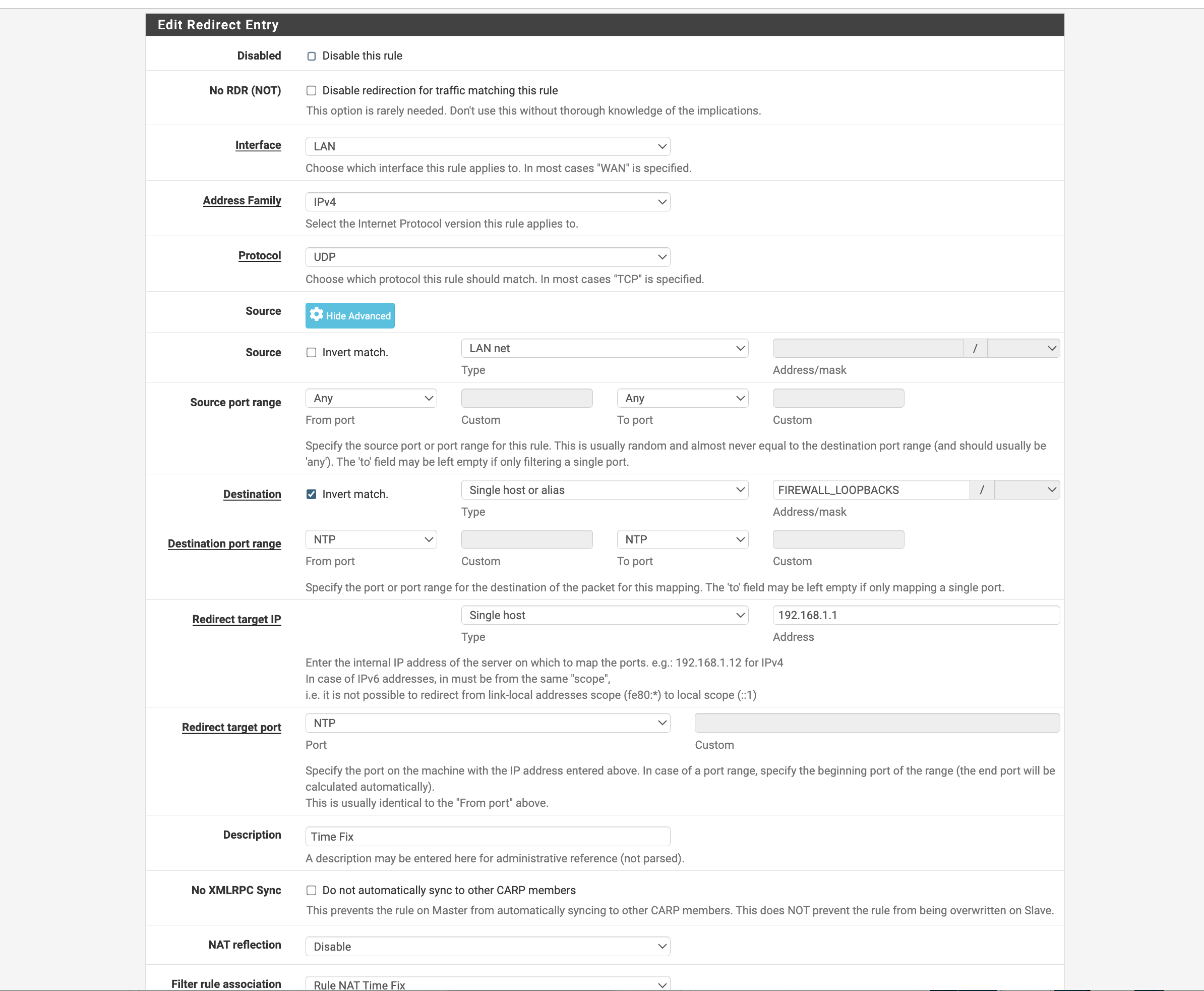

                              @Mission-Ghost have you tried to use a NAT port forwarding rule? This will redirect all requests for NTP to the server of your choice?
                              This is what I do as I had many devices requesting NTP all over.
                              Lan interface -> anything source address inside the Lan net -> over UDP-> any source port -> redirect anything not going to the firewall or loopbacks (any other ntp requests) -> that wants NTP as its destination port
                              This will redirect any NTP requests that are not being sent to the firewall right back to it. Port forwarding.
                              (alias has the firewalls address and its loopback, you would need to make 2 one for IPv6 and one rule for IPv4)

                                Mission-Ghost @JonathanLee
                                @JonathanLee thanks for your post.
                                Yes, my NTP rules are configured to redirect all of my LAN NTP requests to the router's NTP server. Our LAN devices keep excellent time using this.
                                However, it doesn't seem to help with or be a factor in the reboot-then-IPv6-socket request error after reboot since NTP configuration.
