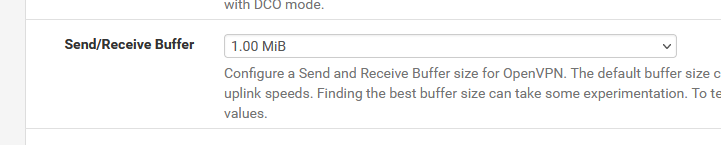

                            edit : and you don't need to add
                            sndbuf 1048576
                            rcvbuf 1048576
                            and these get added as soon as you select :

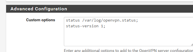

                            Note : my custom config :
                            so these are just added to the rest.

                                  I have also removed the manual entry for regen-sec and send/receive buffer (I used the pfSense GUI to set the send/receive buffer)
