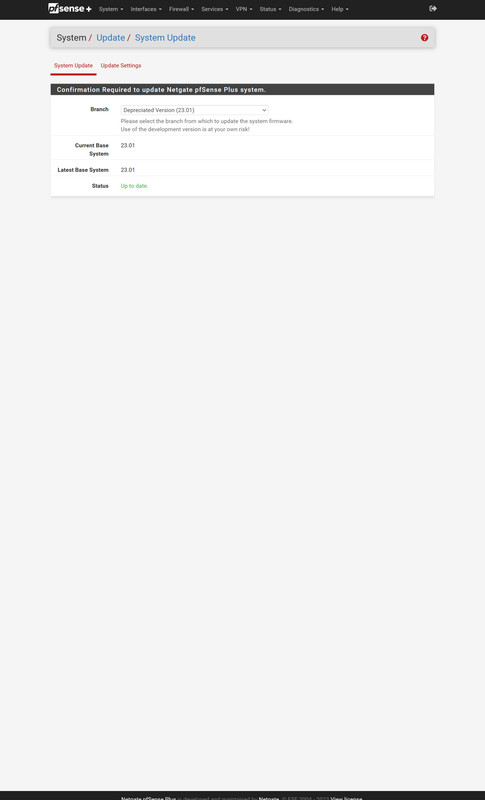

                clawsonn @stephenw10
                Hi, next occurrence what should I check for cpu usage? System activity /diag_system_activity.php and look at what is using highest percentage of WCPU or anything else?
                No particular reason still on this version other than it seemed somewhat stable until this repeated issue started several months. I was going to upgrade earlier but after hitting this issue a while ago I wanted to get more info on root cause and also noticed recent announcements of changes of the PLUS licensing and I have not the time to review and determine what are ideal next steps.
                Thanks for response.
                  There have been numerous issues fixed since 23.01 was released, including some in pfctl. So I would recommend upgrading to 23.09 when you can.

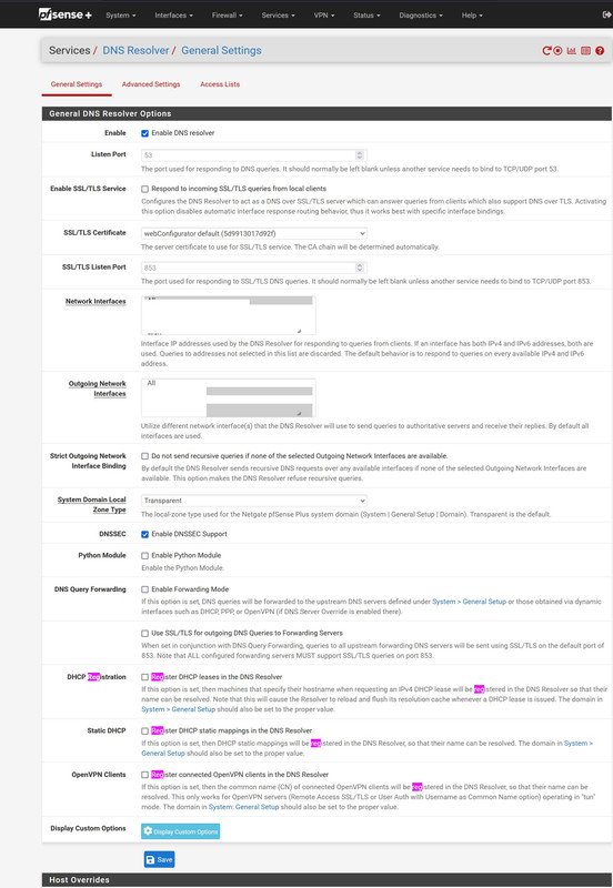

                    clawsonn
                    Event occurred and captured cli output which appears maybe related to unbound.
                    For more context the machine is pfsense 23.01-RELEASE installed on physical intel machine, no vm, with all intel ix 10gbe nics, multivlan, multiwan, and mostly floating rules. There are no packages installed. Mostly vanilla plain settings and configuration. There are no config changes or reloads that occur in between reboots and the machine continues to become nonresponsive on wan lan traffic etc. Seems bizarre that the issue seems to be recurring more and more frequently.
                    Here follows output of CLItop -HaSP

                      I am reviewing resolver unbound logs to see unusual activity. I do see this repeat a couple time
                      Nov 29 18:23:04 unbound 34217 [34217:0] notice: Restart of unbound 1.17.1.
                      Nov 29 18:23:04 unbound 34217 [34217:0] notice: init module 0: validator
                      Nov 29 18:23:04 unbound 34217 [34217:0] notice: init module 1: iterator
                      Nov 29 18:23:04 unbound 34217 [34217:0] info: start of service (unbound 1.17.1).
                      Nov 29 18:23:05 unbound 34217 [34217:3] info: generate keytag query _ta-4f66. NULL IN
                      Unbound settings in 'General DNS Resolver Options':
                      alt text
                      This machine has disabled Python module and disabled DHCP Registration Register DHCP leases in the DNS Resolver.
                      I found another recent reported bug at https://redmine.pfsense.org/issues/14980 that reads similar experience as my machine:
                      "experiencing recurring problems with unbound suddenly becoming unresponsive and running at 100% CPU. Restarting the unbound service brings pfSense back to normal for a while, but then in the next one to three days, unbound freaks out again at 100% CPU until we can manually intervene. "
                      That bug reports "A "truss" of unbound while it is locked up shows it in what appears to be an infinite loop trying to send to a UDP socket and getting back "No buffer space available" errors."
                      Where/how on my pfsense can I find/verify if I am hitting same bug? Where would they be seeing the '"No buffer space available" errors' and/or infinite loop?
                      Thank you

                          Had to set to different branch in System Update to match current system
                          alt text
                          After that was set I was able to install cron package. I also installed System_Patches but don't see https://redmine.pfsense.org/issues/14980
