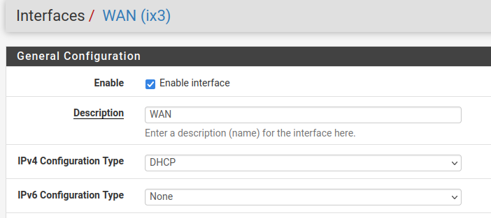

      Hello fellow Netgate community members,
      I have found that, "AAAA records are only used when a domain has an IPv6 address" (cloud flare).
      So if WAN is set to IPv6 none because of ISP restrictions should the unbound DNS still had out AAAA records? The client should not be able to access IPv6 urls right because of no IPv6 wan address? I am just curious as before the unbound resolver didn't have issues with the clients URL requests, and all the sudden they are attempting to connect to IPV6 even if my ISP does not hand out a IPV6 address. It is set to none. Again if the host asks for a AAAA it's going to hand it out. My question is if the WAN already has it set to none why allow it.
      Any thoughts?

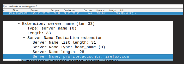

            If you set up a packet capture and check the Hello Packets, you will see a header called SNI (Server name indication), in which it is possible to see where you are connecting to.
            So, if the provider wants to know where you are going, DOH won't stop them.
            You won't be able to cache DNS too, so I would suggest to use the root servers and that is it.

                Anyone in the path would be able to sniff it anyway just the way I showed above, through SNI header.

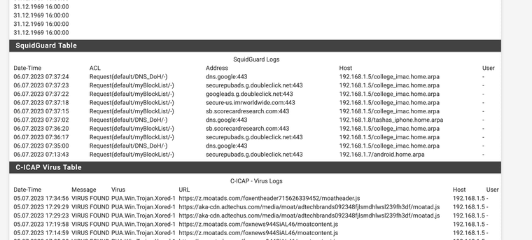

                              @mcury this is exactly how mine is configured currently.
                              Quick confirmation, if my ISP does not hand out IPv6 I have no access to any AAAA based records, meaning I can query them but not browse them with a host.
                              My goal is to have clamav work better as well as have the url filter get more visibility, I do block DoH my own list and a blacklist of blocks.

                                  Destinations that are in the bypass list, the client will connect directly to the destination, thus not breaking the HTTPS.
                                  So, either way, lots of maintenance and tweaking, forever because the Internet is not static.
                                  I would say that an antivirus solution installed at the client side is a much better solution.
                                  And, If you really need to block things, check if you can do it by using DNS using the method I mentioned above, disabling DOT/DOH/QUIC and etc.
                                  This is my experience with using proxy for a long time, and I can say one thing for sure, people will call you everyday because something is "not working".
