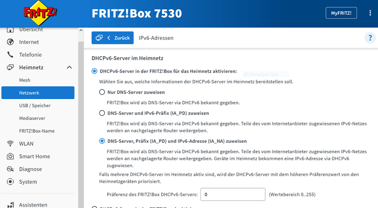

              • Bob.DigB Offline
                Bob.Dig LAYER 8 @Ofloo
                @Ofloo said in NPt IPv6 behind double nat:
                or something like this?
                So you have a Fritzbox, many are able to further delegate, you find the option here:
                O 1 Reply Last reply Reply Quote 0
                • O Offline
                  Ofloo @Bob.Dig
                  @Bob-Dig I've set the setting of dhcp to what you've told me and client to dhcp instead of slaac, however no difference. pfsense it self does route however the clients in a different /64 do not. Are there any additional settings I need to set to the dhcp client?
