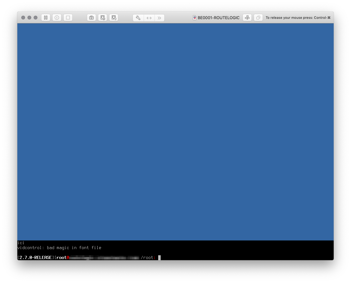

      First thing I did was changing the keyboard layout because it won't stick. But as soon as I did I got this error:
      …and the layout didn't change, or not until the next session but not for the selected but one close enough, it seems. Then I remembered this tip of setting it using the keymap variable in /etc/rc.conf.local, it's still a little off but at least I don't have to face the error.

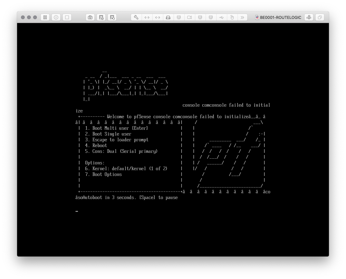

      Also, when the systems boots up, there's some character/video-related glitches:
      (If you know how to fix this—a package install like the localectl module on Linux maybe—please, tell.)
