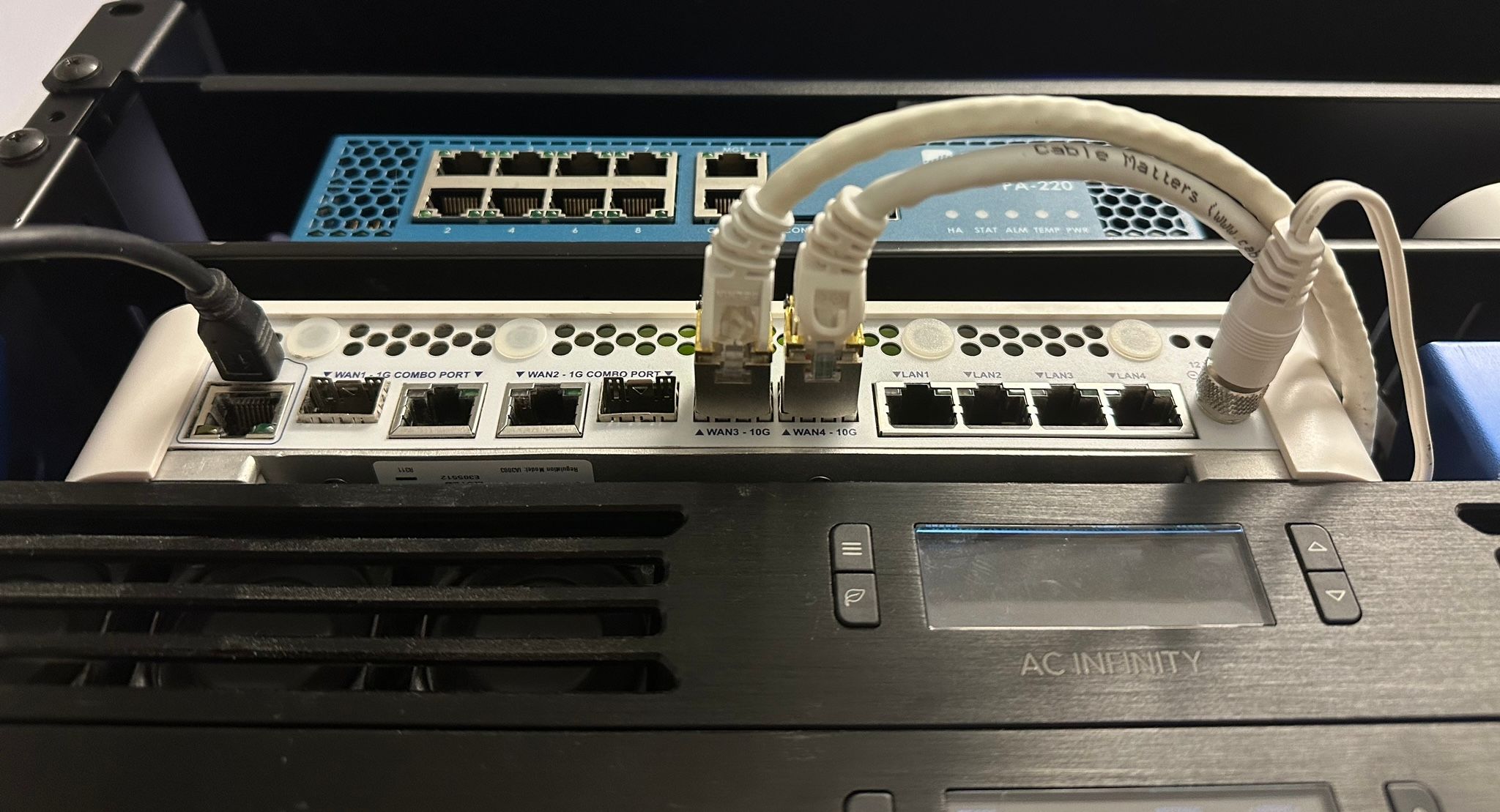

      They do get hot AF, but I've been using two of them side-by-side in my 6100 MAX for months without issue (no errors either). I am only using a second one on my LAN connection because I redid my UniFi rack and I didn't have a DAC cable long enough. I just used another one of these MicroTok transceivers with a CAT6 cable that was already behind the wall connecting my two racks. I would use them again.

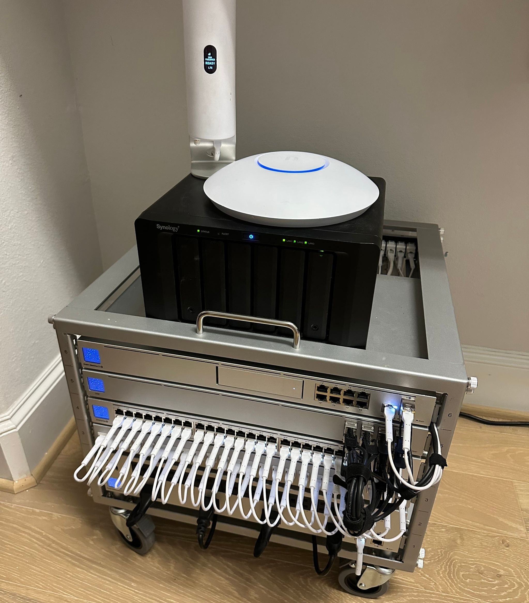

                      Yikes! Don't look now but your Synology Box has been captured by a UFO!!! 😲
                      Phizix
                      RobbieTTR 1 Reply Last reply Reply Quote 2

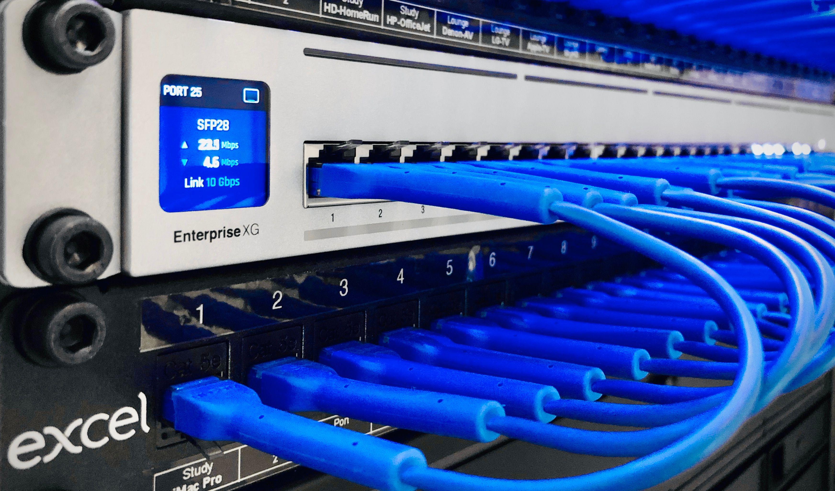

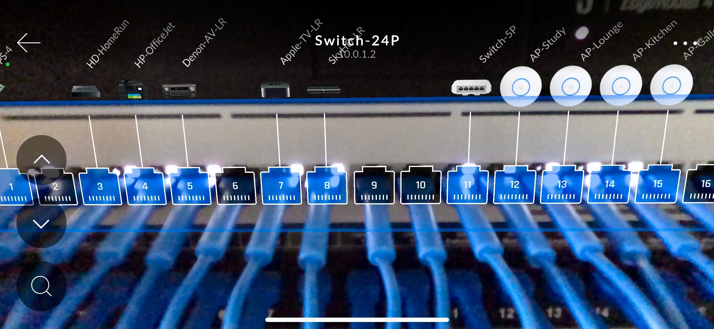

                        The UFOs are attacking my switch:
                        DefenderLLCD 1 Reply Last reply Reply Quote 1

                          Love your XG switch. I have four UniFi 6 Enterprise UFOs connected at 2.5Gb on my Enterprise 48! I'm out of town right now, so I can't do the AR thing, so here's an older one before I switched to pfBlockerNG!
