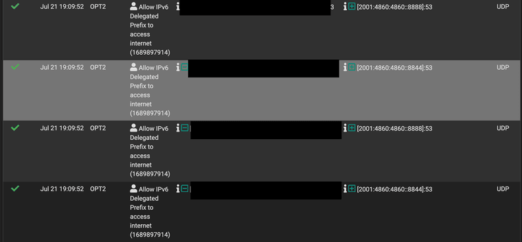

      I've got a delegated IPv6 Prefix to a secondary router and I'm having trouble getting my clients to have internet access through that router with the delegated prefix:

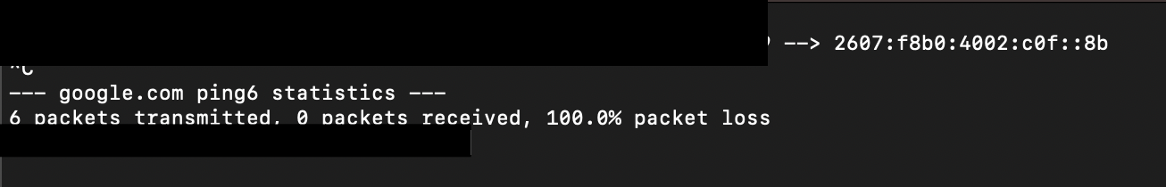

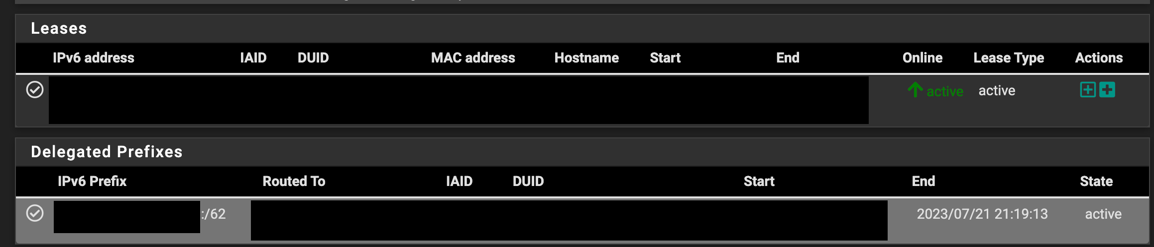

      Screenshot 2023-07-21 at 3.12.49 PM.png I've got a firewall rule that allows this prefix to go to any address using any protocol and I enabled logging so I can clearly see that isn't the issue. I only get a /60 from my ISP (AT&T) so I'm delegating a /62 to my other router.Screenshot 2023-07-21 at 3.38.09 PM.png but pings from clients fail:

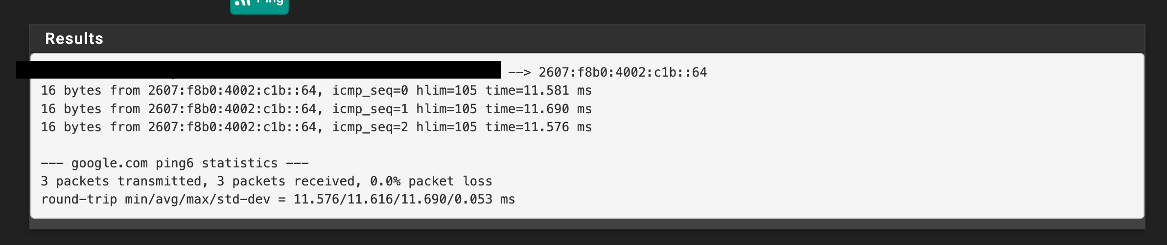

      basically I'm asking what the best way to trouble shoot this further is because what has me really confused is that pings from the firewall are fine so it clearly has a valid addressScreenshot 2023-07-21 at 3.41.51 PM.png
