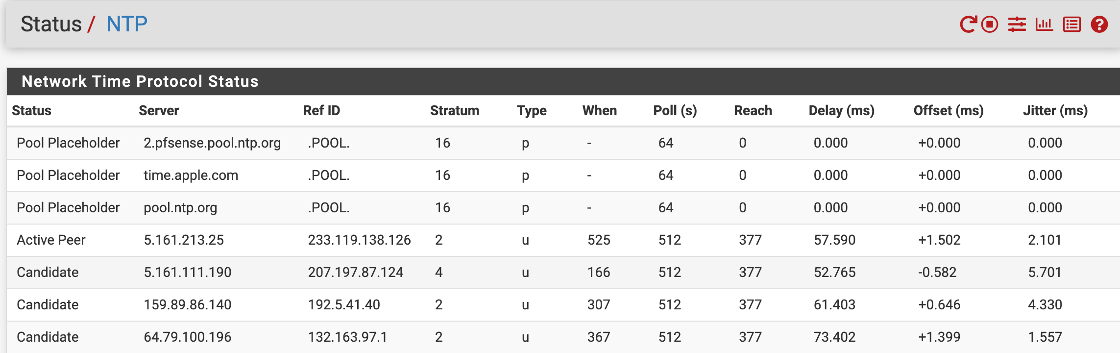

        @jrey said in NTP Sync has stopped.:
        I've changed the pools to try a couple of others, restarted the service and eventually just rebooted.
        Here's mine and I have used these three for the longest time and never had an issue I have noticed. I like to use time.apple.com because most of my devices are Apple's. In the pass, I have used time.google.com also.
