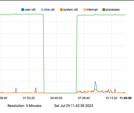

      2100 - running 23.05.1 - generally very stable for months until 3:25 am this morning. (the only time system generally gets started is during updates)
      The last log entry just prior to the halt/outage was ACME reporting that the certificate did not need update. (Normal for this time of the day)
      There doesn't seem to be any reason logged, no crash report etc.
      This morning when it was discovered there was no internet from anything internal, I tried connecting to the NetGate, no connection.
      Could not ping, Could not SSH. No response on console (of course it was hooked up after), but I couldn't get a response.
      The blue light on the front was stilll blinking "normally".
      Devices going through the NG switch could not talk to each other,
      that is ports LAN 1 <-> LAN 2 <-> LAN 3 could not talk (everything is on the same subnet, so there are no rules internally between the ports on the NG)
      devices connected on the Switch connected to LAN1 could talk to each other, similarly devices connected to LAN2 or LAN3 could talk on their own switch, but through the NG was a no go.
      It is almost like the system received a halt now command. But there is nothing logged regarding this, and "normally there would be"
      After several attempts to connect, I finally decided there was no other choice and pulled the power. (normally it is on UPS)
      It rebooted and has been fine since.

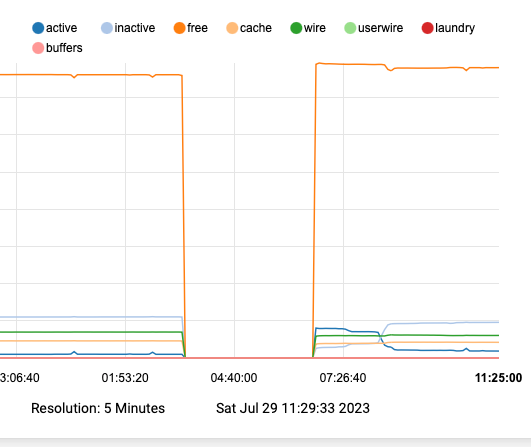

      Every monitoring graph shows everything just stopped.
      There was no WAN drop logged
      There is zero traffic logged WAN or LAN during the outage until the reboot, those graphs are flat as well.

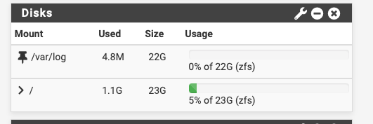

      Plenty'O-Disk
