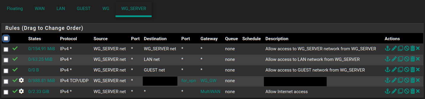

      Basically I have the following:
      • LAN
      • Wireguard server on pfSense
      • Remote Wireguard server
      • URL alias that points to ~14k IP subnets
      For both LAN and Wireguard server interface last rule is to send traffic through WAN (I have Multi-WAN configured to be specific) and rule before that is to send everything corresponding to that URL alias through remote Wireguard server:
      This works great when connecting to pfSense through it's Wireguard server and doesn't work on LAN for most IPs most of the time (sometimes it does work, not sure why though, maybe rules are reloaded at the time or something, very strange).
      I'm confused as to how this is possible with identical rules, any ideas how to debug this and where to look?

            To me it looks like the Lan rule (i suppose it's the TCP/UDP rule) , has been "hit" by 593.80MB data (See States collum)
            Why it's not working (forwarding) is a totally different "issue".
            But the rule seems to do (match) what it's supposed to.

                              I looked at this again, just to test things out I have modified the rule to allow any protocol, not just 80/443 ports TCP/UDP and surely enough, traceroute shows that I am routed through WireGuard server:
                              nazar-pc@nazar-pc:~> traceroute a.b.c.d
                              traceroute to a.b.c.d (a.b.c.d), 64 hops max
                                1   10.13.13.1  31,048ms  31,602ms  30,619ms
                                2   192.168.160.1  30,959ms  30,653ms  30,894ms
                              Where 10.13.13.1 is a WireGuard server that pfSense is a client of. So apparently the packets are going the right way, the question then is why TCP/UDP packets are not working the way I expect them to.
                              I then checked if I can open it in the browser and... it does open 🤔
                              I have edited the rule back to what it was and it still works, killed the states associated with the rule and it still works.
                              I'm very confused right now 😕
                              I'm happy that it started to work, but I do not understand why it does or rather why it didn't before with exactly the same settings 🤷
                              nazar-pcN 1 Reply Last reply Reply Quote 0
