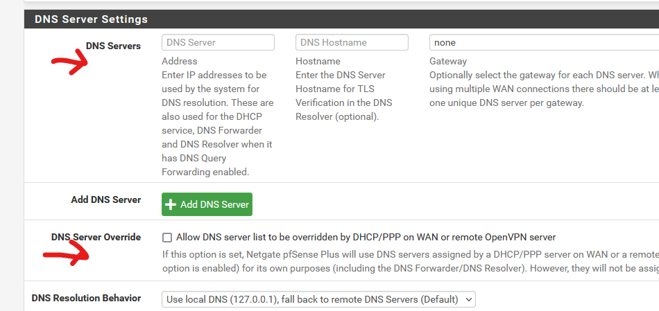

      otherwise the servers configured in General settings or those obtained dynamically."
      What have you set here :
      L 1 Reply Last reply Jul 31, 2023, 4:01 PM Reply Quote 0

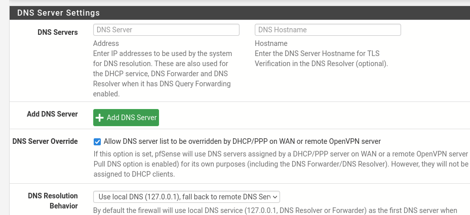

        It looks like this:
        With DNS Server Override checked. This was the default setting when I installed pfSense. The only thing I changed in the GUI after the install was disabling the DNS Forwarder.
        Reading the text under DNS Server Override it says that this will not be used for DHCP Clients. But that kinds of contradicts what was written under the DHCP Server.
