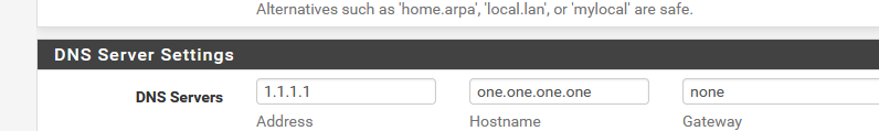

                    @hardware_bxl said in Buggy DNS behavior:
                    The hostname for DoT is optional
                    I'll share my thoughts :
                    When you do TLS, you have to use a host name.
                    The host name has to be resolved so an IP is obtained.
                    The IP is contacted, TLS is started, certificates come in, and these certificates should be valid and contain the host name of the contacted service. if these checks are valid, the connection is valid.
                    That's the way 'https web browing' works : try to contact a this forum using it's IPv4 or IPv6 : https://208.123.73.199/ : your browser will bark.
                    So, when I had to use forwarding :
                    I would enter "1.1.1.1" and the correct host name : "one.one.one.one" because :
                    [23.05.1-RELEASE][root@pfSense.bhf.net]/root: host 1.1.1.1
                    1.1.1.1.in-addr.arpa domain name pointer one.one.one.one.
                    It might be so that this relation between IP and host name is not enforced by unbound (I'm not sure, as I've people entering nothing or just pure comments in the host name field) when doing DNS over TLS : I find that pretty flawed, as when 1.1.1.1 gets spoof routed' to not the real 1.1.1.1 then ..... bye bye security ...

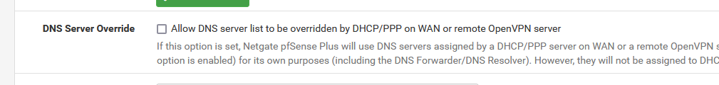

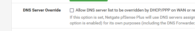

                        If you have not set this
                        (if you set that, then also upstream router or ISP DNS becomes part of your local list with DNSs to use , competing with 127.0.0.1, which is the access point to unbound)

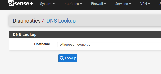

                          It gets even weirder, because it goes through the Resolver (127.0.0.1) indeed, but something else happens:
                          Single LAN, single WAN, Resolver forwarding over TLS, Cloudflare dns servers
                          When you do Diagnostics - DNS Lookup - Hostname: ibm.com
                          Result:
                          The DNS request is dropped @ 127.0.0.1 (Resolver) and is indeed forwarded to 1.1.1.1:853 etc.
                          BUT it also creates a DNS request 1.1.1.1:53 (!) and the hostname ibm.com is also resolved over port 53.
                          HOWEVER: DNS Lookup does NOT get any result back from these regular DNS requests, it will simply fail if you change the Cloudflare IPs to something not reachable.
                          I'm getting really confused now and wondering if for whatever reason it's my setup, but I do nothing, because I install pfSense and do the only config I mentioned before, nothing more. I hope someone can say me...

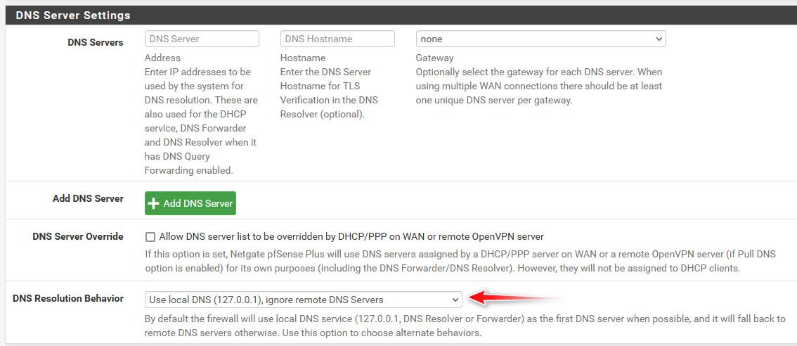

                            johnpoz LAYER 8 Global Moderator @hardware_bxl
                            Because that is going to talk to all servers listed in dns.. When loopback 127.0.0.1 is asked, then it will forward. When it asks say 8.8.8.8 that is listed in there or 1.1.1.1 listed in there it would just be over normal dns..
                            What do you have this set too?
                            There is a big difference in the diagnostic gui dns lookup, and a client only asking unbound.. If you want to test what unbound does, then ask unbound via a client

                              DNS Resolution Behavior is set to what you show:
                              Use Local DNS (127.0.0.1), ignore remote DNS Servers.
                              Forcing the use of the Resolver that is configured for DoT.
