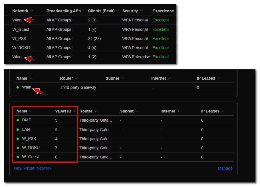

              johnpoz LAYER 8 Global Moderator @Lobanz
              @Lobanz the controller and AP can be on a tagged vlan.. They added this feature quite some time ago.
              But yes controller and AP are untagged, mine currently are. And I also have a SSID that is untagged, and other SSIDs that are tagged. The untagged vlan is the same the AP and controller are on.
              Actually I have 2 ssids that end up on the untagged network. One use psk, the other is eap-tls..
              That wlan network is untagged, all the other networks are tagged..

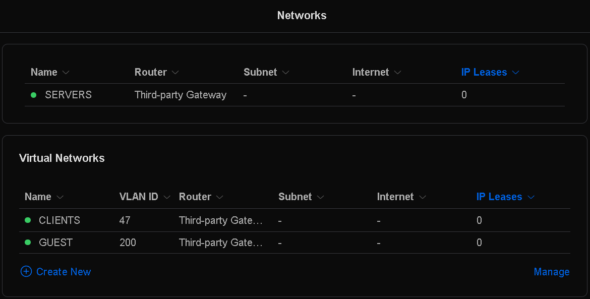

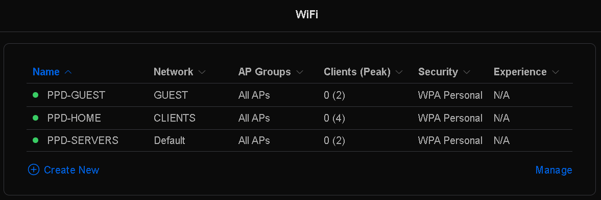

              • L Offline
                Lobanz @johnpoz
                @johnpoz Awesome!
                Getting there!
                So, essentiually, on the networks screen, the top section is UNTAGGED networks, and the "Virtual Networks" are the TAGGED networks. That helps!
                So, then I made my PPD_SERVERS SSID point to the Default network (the same VLAN (10) where the Unifi Controller and the APs live) it started working. But if I define a WiFi SSID that is tagged for VLAN 10, it no werky.
                So one more question:
                Why can't I rename the "Default" network to something else?
                Running Network Version 7.4.162. AP firmware 6.5.62.14788.
                --- Lobanz

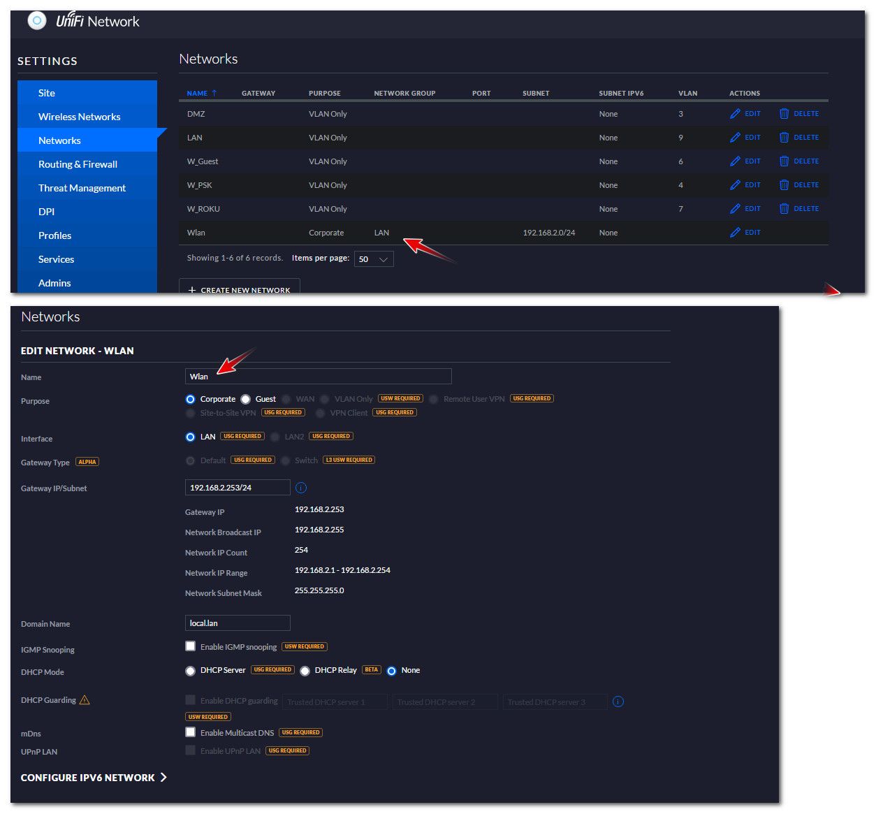

                  @Lobanz as to renaming it - hmmm.. Never looked into that. I named mine from the get go from what I can remember..
                  I am running 7.5.169 for controller. And 6.5.64 for firmware.
                  Ah -- you prob need to switch to the legacy interface to change the network name.
                  As to 10 not working when you tagged it - because it wasn't a tagged vlan.. On your switch ports..

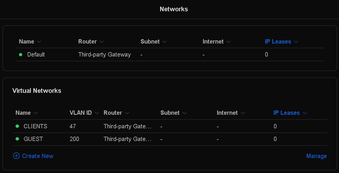

                  • L Offline
                    Lobanz @johnpoz
                    @johnpoz said in pfsense unifi dhcp problem DHCPREQUEST / DHCPACK vs DHCPDISCOVER / DHCPOFFER:
                    Ha! Yes. I flipped back to legacy, made the change and then found my way back to the new interface. Now it's the way I want it. Thanks!
                    SOLVED!
