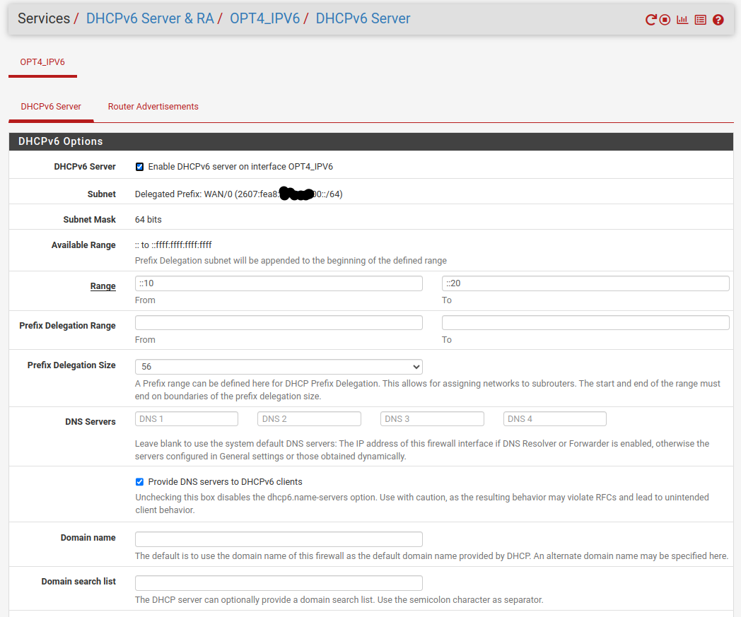

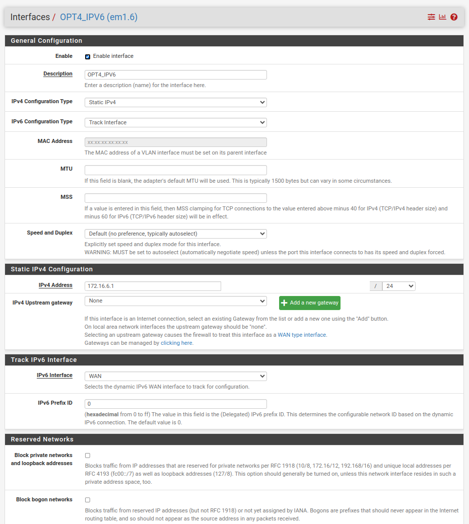

            Here is how I have the interface set up:
            and the DHCPv6 Server tab looks like this (nothing in the area below what is shown)
            I have this connected to through an SG300 switch as an untagged access port which connects to a linux laptop. The laptop has the wired interface connected with both IPV4/6 set to automatic.
            DNS4 got picked up correctly (I force all DNS to go through pfSense}, but the only way I could get IPv6 going was to manually code a DNSv6 server address on the laptop. Since my endgame is to supply IPv6 for a TV box with limited configurablilty I pretty sure I need to get DHCPv6 passing along a DNSv6 server address. (@JKnott do you know if am I mistaken on this?)
            What I also find interesting is that the interface has 2 gua (both in the delegated prefix). In the NDP Table, one address has a lease, and the other is permanent. The permanent address has exactly the same bottom 3 hextets as all the other interfaces, but the 4th hextet is different. What is going on here? Also given that I have set IPv6 to configuration None, why do all the other interfaces have an IPv6 address in the NDP Table? Is this going to cause problems?
