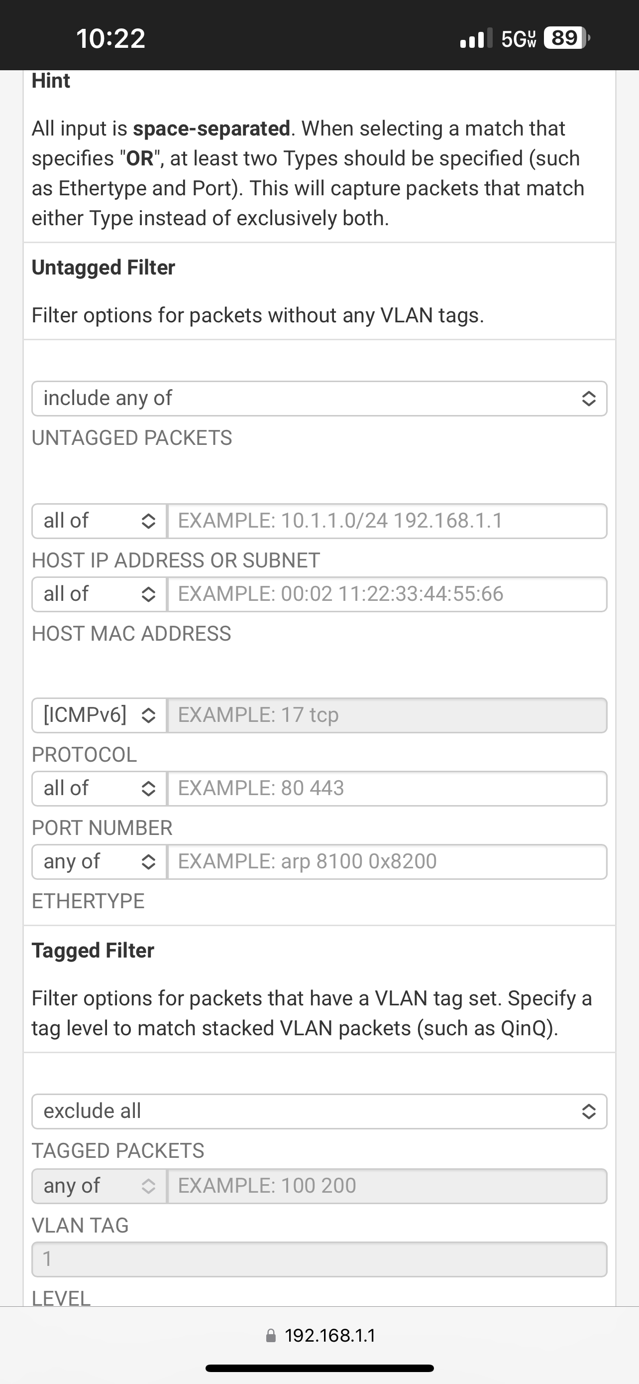

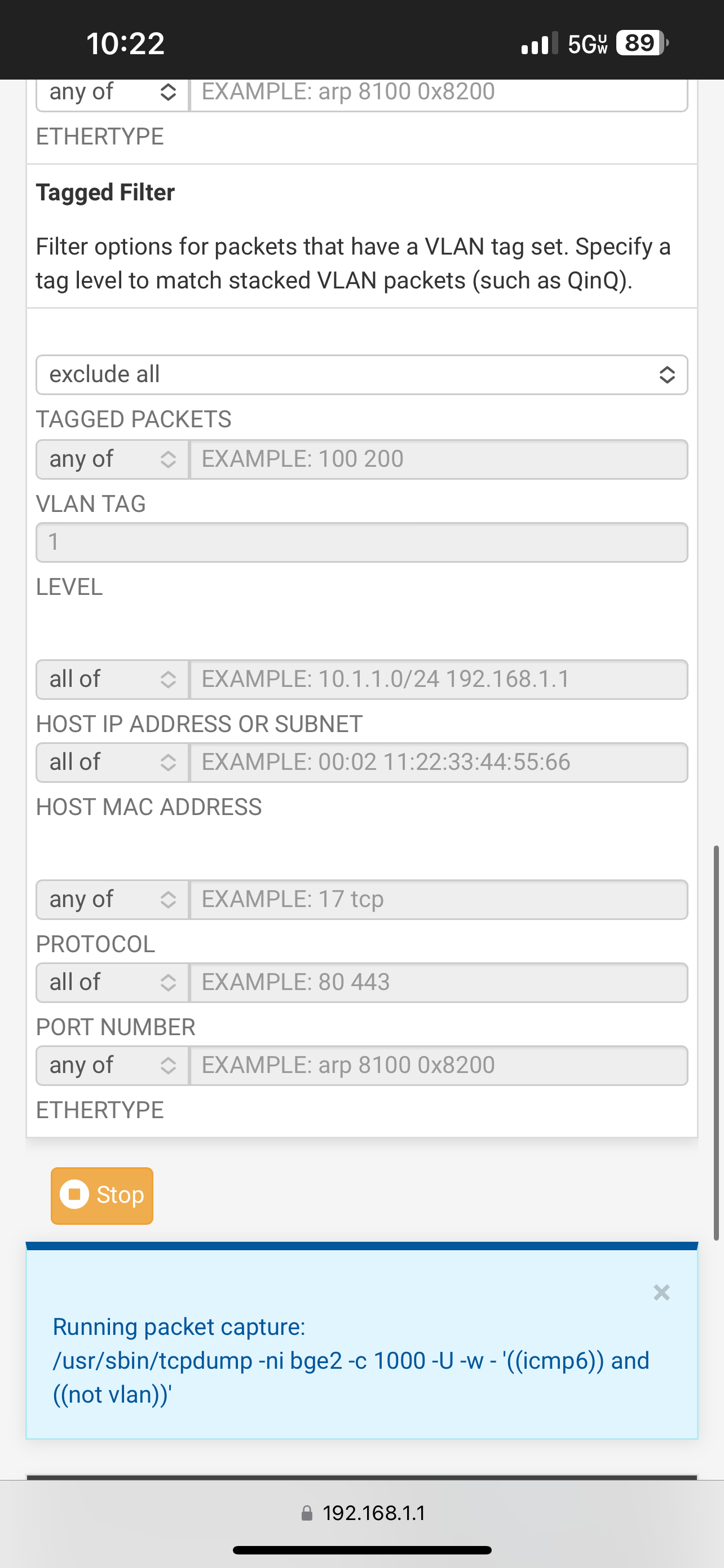

                  No, use the Packet Capture utility. It's under Diagostics. Configure it to capture ICMP6 on your LAN. Let it run for a few minutes and then stop it. Then download the capture file and post it here.

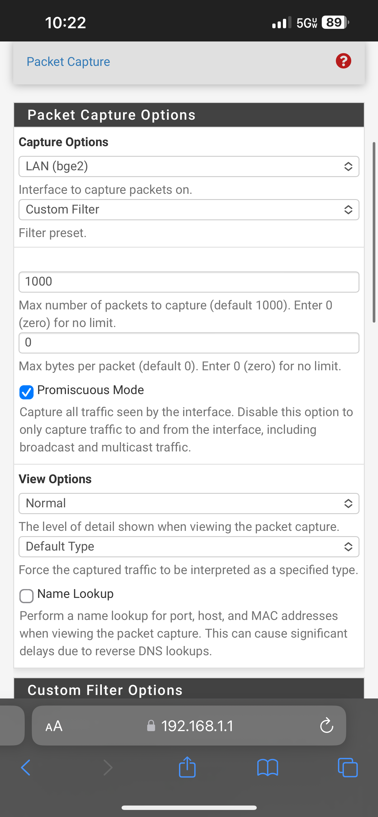

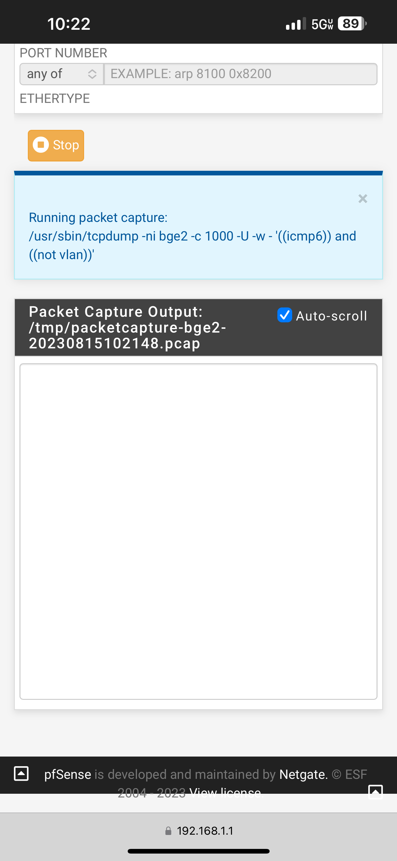

                    @JKnott OHH I see the upload file option. When I run the packet capture under diagnostics, Under untagged filter I included any of my lan ip 192.168.1.1 and ICMPv6 I don't see ICMP6 and that came up blank. when I run it under tagged i get the same thing, blank.
                        sfigueroa @sfigueroa
                        @sfigueroa wait i got something, i dont have many devices on the lan right now so ill let it run for a bit

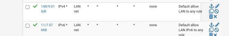

                              @JKnott yea no I understand. So my lan devices to get ipv6 but when I go to for example: google.com and search for what is my ip and click any of the providers they only detect ipv4 and ipv6 shows up as not detected. I have a rule allowing ipv6 out from the lanIMG_4370.jpeg

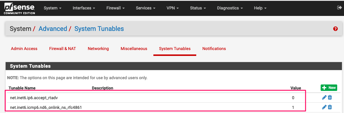

                                I see you appear to be running an older version of pfSense. Any reason you're not running 2.7?
                                Why are you in system tunables?

                                  Why are you in system tunables? I was running the system tunable based on the guide, to be honest, I'm not well versed on that part. Should I not be doing that and leave it as is?

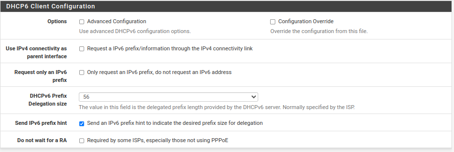

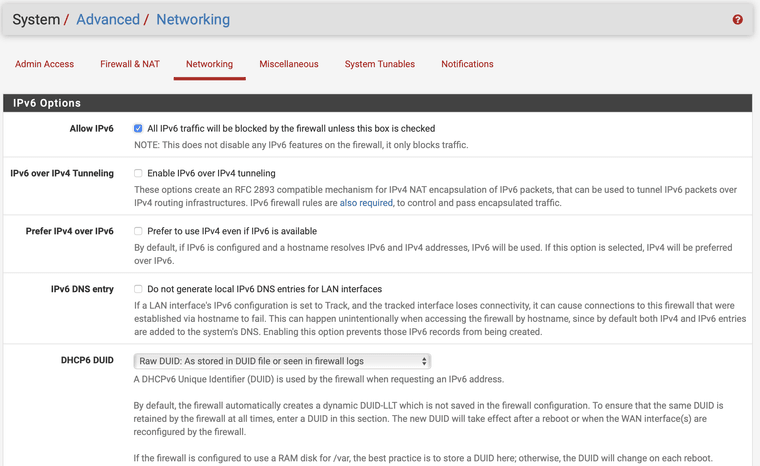

                                    Your dhcp6 client config show a setting for Do not allow PD/Address release. In 2.7 that setting is on a different page.

                                    Do you have a wired connection? If so, lets start with that to keep things simple. Also, I have been running pfSense for over 7.5 years and never had any reason to go into tunables.

                                    In your packet capture images. You have VLAN 1. Why?

                                      In your packet capture images. You have VLAN 1. Why? I have multiple interfaces, however, I do have a switch. Let me get home and take a look at it to make sure nothing is going on there but I'm pretty sure I don't have vlans set up there.
                                      Your dhcp6 client config show a setting for Do not allow PD/Address release. In 2.7 that setting is on a different page. Do I uncheck this? I have never seen that before.
                                        The thing is, it shouldn't be there in your dhcp6 config, if you're on 2.7.

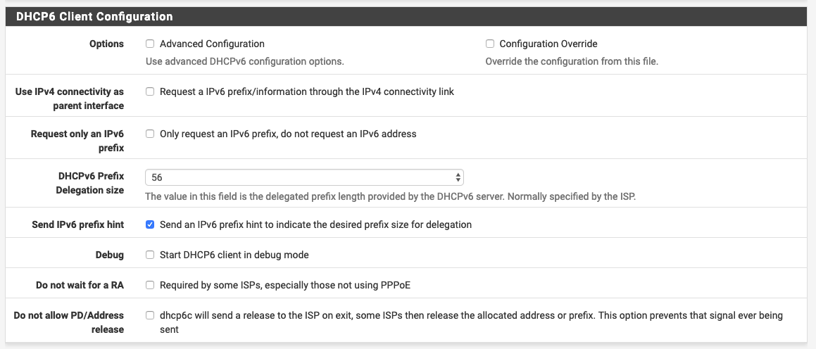

                                            Here's what my dhcp6 client shows:

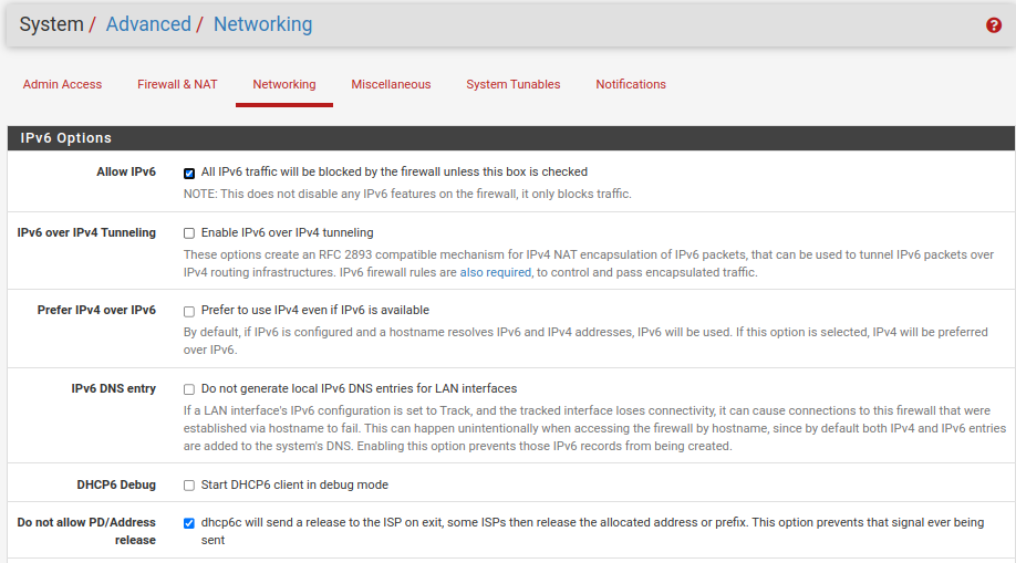

                                            That setting isn't there.
                                            It's here:
                                            So, if you have that Do not allow PD/Address release setting on the dhcp6 client config, you have a really strange system.
