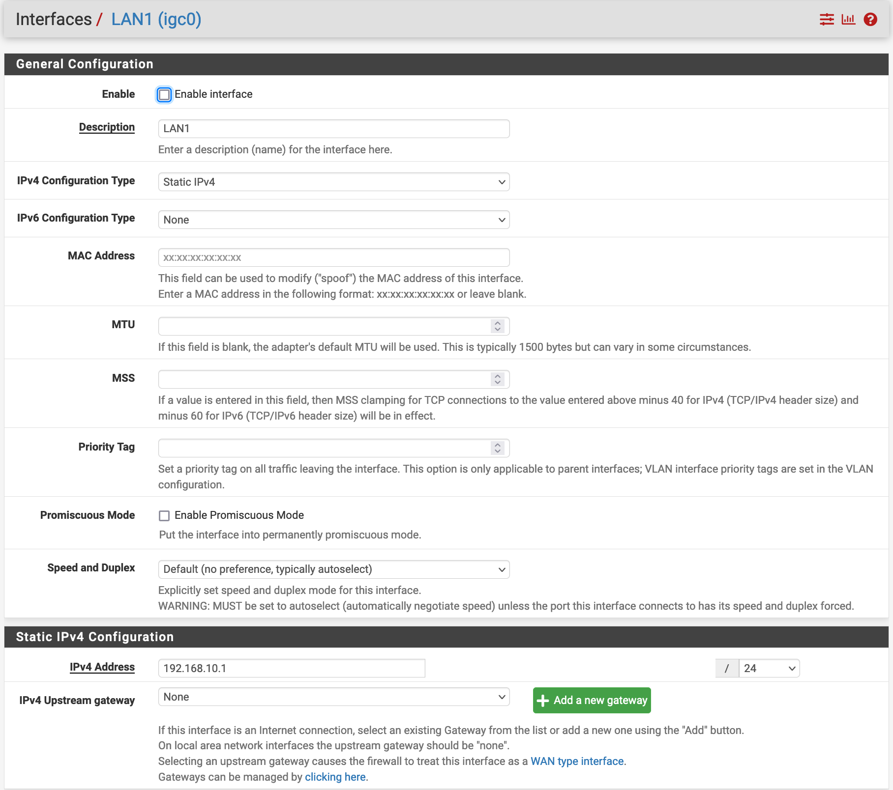

            @SteveITS so clearly I'm just blind ๐Ÿคฆ
            Equally confirmed in the backup xml file

            What is unclear to me though is that this interface isn't enabled and even further what is the logic behind choosing to resolve the routers hostname "pfsense.lan" to LAN1, why not the any other interface especially if they are at least enabled. It would make more sense if I had actually defined a DNS entry but this seems almost randomly picked

              @johnsoga It's not quite random, looks like that used to be your LAN, given the <lan> tag? Might be considered a bug that it's pulling that, but otherwise, not sure which interface it should use. I'd guess pfSense is just assuming the LAN interface is always active.
              Ideally "whatever interface I'm using" is probably the best, since often other networks can't connect to the LAN IP anyway, but I doubt it can do that. I would think Unbound could have A records for all interfaces but then DNS probably wouldn't know which to use and would normally send all of the IPs. pfSense stores/uses the driver interface name (igc0), the internal interface (lan), and the description (LAN1).
              IOW pfSense wants to default itself to something so it picks LAN instead of WAN, assuming that's enabled for everyone, and you just happened to have disabled LAN.
              In theory you could edit your config file to swap <lan> and <opt1> or whatever. You just have to update it throughout the file since the opt1 name will be used in various sections like DHCP and firewall rules.
