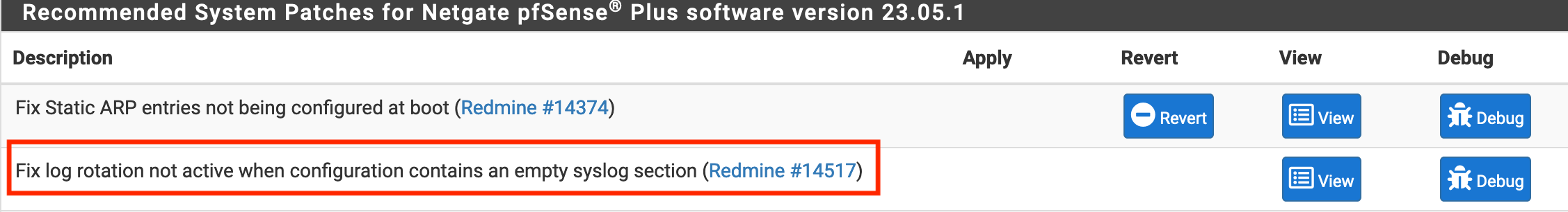

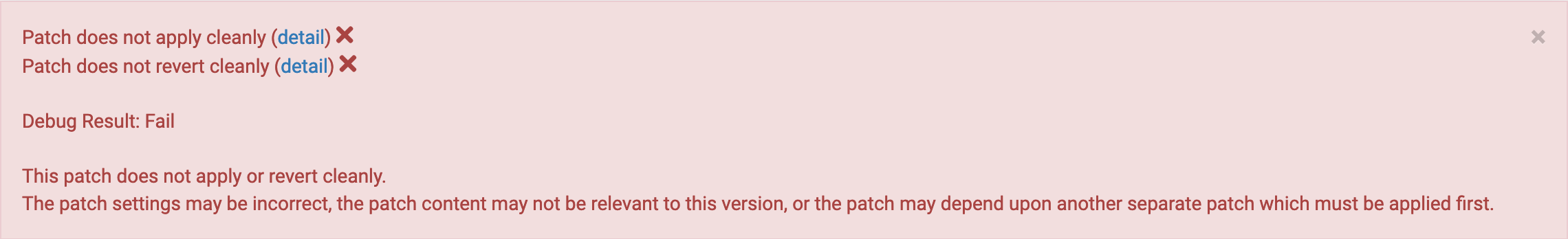

        • E Offline
          emikaadeo
          For me this patch doesn't apply cleanly:
          pfSense+ 23.05.1 (amd64)
          No custom/manual patches.
          Debug:
          /usr/bin/patch --directory='/' -t  --strip '2' -i '/usr/local/pkg/patches/892de1ecdaa23b164f6b2a2251d7538eee2199ea.patch' --check --forward --ignore-whitespace
          Hmm...  Looks like a unified diff to me...
          The text leading up to this was:
          |commit 892de1ecdaa23b164f6b2a2251d7538eee2199ea
          |Author: jim-p <jimp@netgate.com>
          |Date:   Wed Jun 28 08:50:07 2023 -0400
          |    Fix invalid log rotation setup test. Fixes #14517
          |diff --git a/src/etc/inc/syslog.inc b/src/etc/inc/syslog.inc
          |index 013de691ac..64551bfed2 100644
          |--- a/src/etc/inc/syslog.inc
          |+++ b/src/etc/inc/syslog.inc
          Patching file etc/inc/syslog.inc using Plan A...
          Hunk #1 failed at 517.
          1 out of 1 hunks failed while patching etc/inc/syslog.inc
          done
          • jimpJ Offline
            It's already applied.
            You can't revert it because the patch below it affected that code as well so you have to revert the other one, then it can be reverted.
            Do not Chat/PM for help!
            E D 2 Replies Last reply Reply Quote 1
