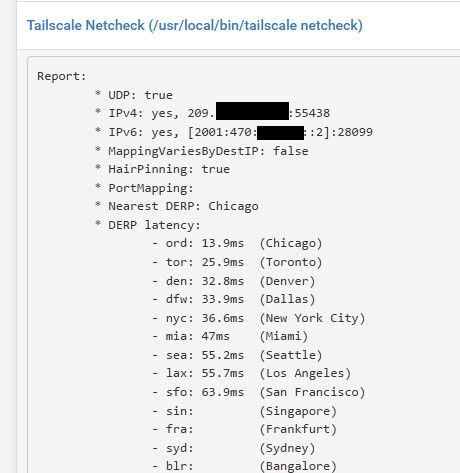

            Your only showing the status section - what does your netcheck section say? Example
              I don't have the exact output (for reasons you'll see below) but it was along the lines of "tailscale not connected". Which makes sense because it can't communicate with the coordination server because it is using a DNS response that won't ever work. I can also confirm that it has never used the auth key that I generated for it, therefore can confirm it did not reach the server.
              I rebooted to try to clear things out and now I've lost remote connection to it and I don't have hands there to help at the moment. This means that it somehow forgot my interface configuration? At this point I'm going to have to do a much deeper dive into what is wrong with this unit (Sadly this is my first experience with pfsense so not looking good). Thank you for trying to help.

                  On my netgate router the tailscale netcheck comes back with no result for IPv4. its result is the string (no addr found)

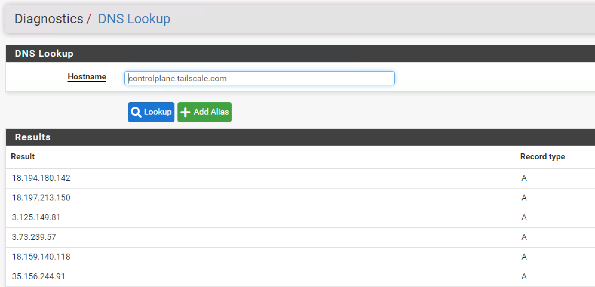

                  • johnpozJ Online
                    johnpoz LAYER 8 Global Moderator @jakedn
                    @jakedn so from my understanding these are the fqdn that are required for tailscale to work. Not sure if all are needed, but would validate you can resolve them.
                    The list of coordination servers (required for authentication, key exchange, firewall updates, and so on) is likely to change, but infrequently:
                        login.tailscale.com
                        controlplane.tailscale.com
                        log.tailscale.com
                        log.tailscale.io
                    So from like pfsense can you do a trace to that controlplane one. This is how unbound would "resolve" which is how it works out of the box, vs forwarding

                    [23.05.1-RELEASE][admin@sg4860.local.lan]/root:
                    Now does it work when say you query say 8.8.8.8 directly
                    [23.05.1-RELEASE][admin@sg4860.local.lan]/root: dig controlplane.tailscale.com @8.8.8.8
