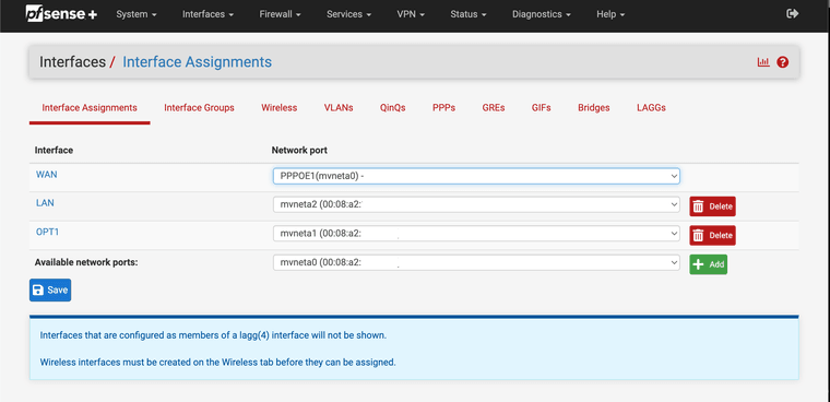

          @stephenw10 Thanks for the quick reply but still can't see what i'm doing wrong.
          I can ping both PI's from each other so the IP's and switch are good, I just can't ping them from pfSense (either mvneta1, no IP set though, or nvneta0)
          mvneta0 (WAN) and mvneta1 (OPT) as BRIDGE0 members
          mvneta0 has IP address
          Do I need to change any of the advanced settings like edge, autoedge?
          or set BRIDGE0 as an interface? Although I did try and still couldn't ping the PI's.
          Guessing the VLAN setting under switches can be left disabled and with the default VLAN's? I've never had much luck with bridging stuff. lol
          1 Reply Last reply
          Reply Quote 0
          • stephenw10S
            Ok, so you have reassigned all the interfaces there, which is fine as long as the external ports are actually connected to what you think they are.
            Your WAN is PPPoE which eliminates using the /29 directly on the WAN via the switch.
            I assume the main PPPoE WAN connection is working as expected?
            Is the /29 routed to you via some other public IP or supplied directly on the WAN?
            paulcdbP 1 Reply Last reply
