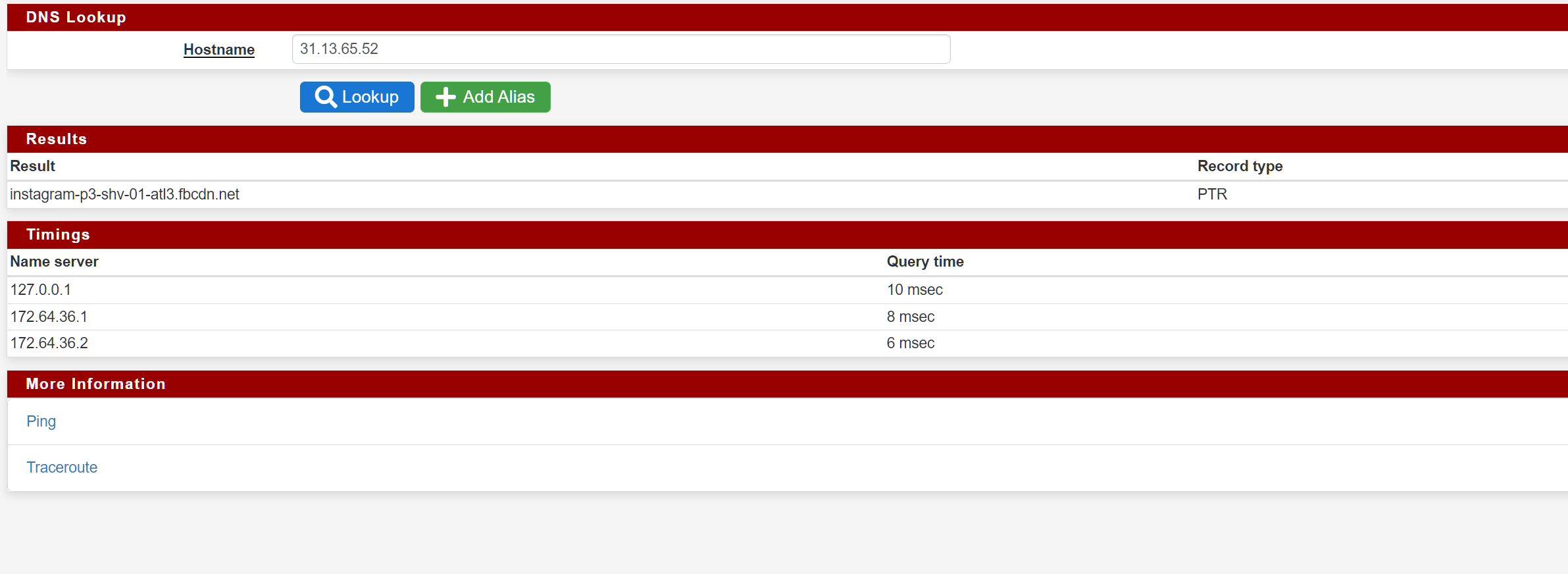

                      When i try to lookup via pfSense ..nothing.
                      Then there are entries that do have a PTR record and yet the LightSquid Reporting doesnt put the DNS name. Example

                      Whatever is going on here , between Squid choosing a IPv6 path [see screen shot in previous thread] and its inability to do reverse DNS , this is all related. Something is probably misconfigured but i cant figure out what it is.

                              @johnpoz My understanding is that pfSense resolves the IP address to hostnames. Theres a setting for that in Squid Proxy Reports.

                                @michmoor I believe that is for clients IPs.. I don't currently have squid or squid reports or anything installed, guess I could to take a look. But anything you google for squid PTR all comes up talking about the client IP.
                                from back in the day, when I ran proxies for living ;) we almost always blocked direct IP access, and only specific ones were whitelisted. Not sure why a proxy would want to look up PTRs when you normally block direct IP access, etc. ;)
                                But for clients, you could use client names in rules that allow, deny etc. So since client IPs might change you might want to do ptr on client IPs to know if its specific client based on its name.
