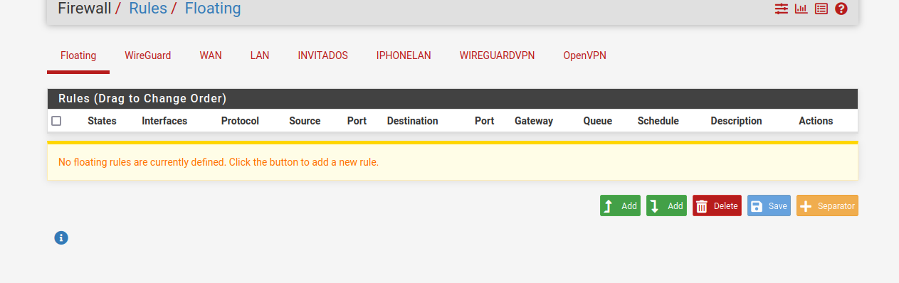

            @killmasta93 you have no rules in floating from pfblocker. Or other?

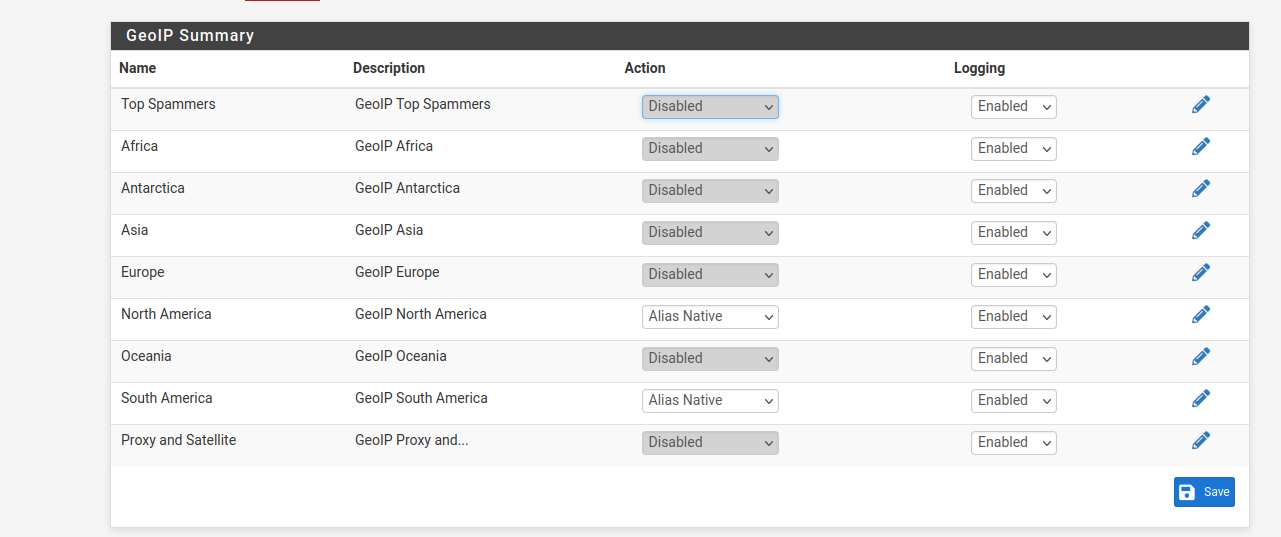

            • K Offline
              killmasta93 @johnpoz
              @johnpoz Hi thank you for the reply,
              Correct no floating rules

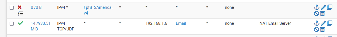

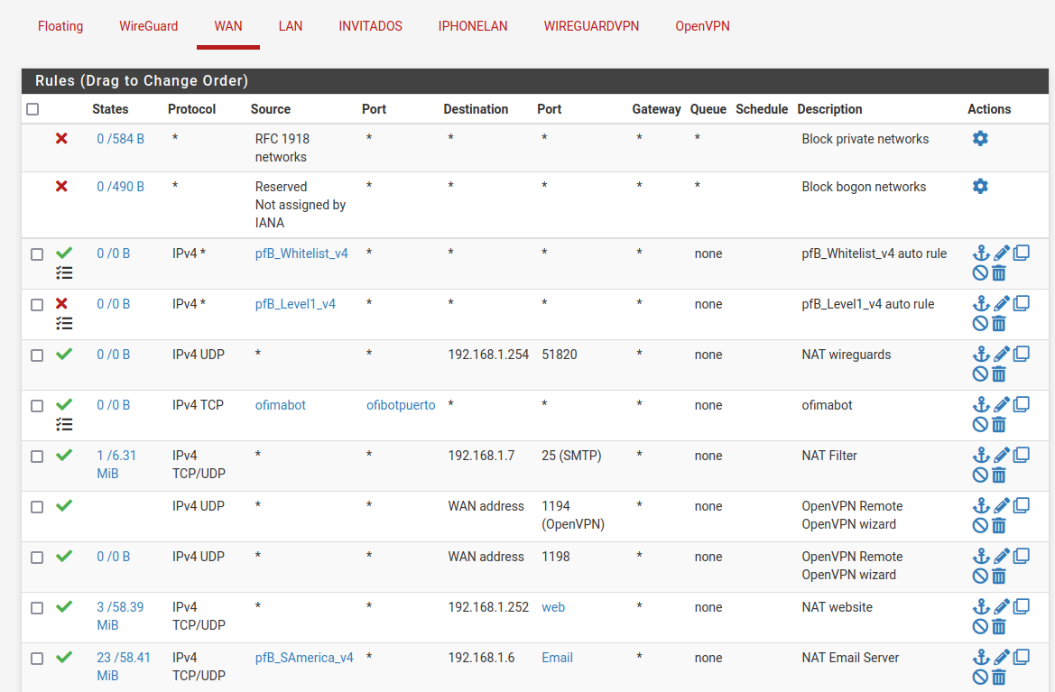

              sure im attaching the rules
              so in this case i have a rule to block everything beside south America to the ports 465
              as you can see pfblocker is working an its on using alias
              also tried to delete the states,
              I know if i reboot it starts working everything
              Thank you

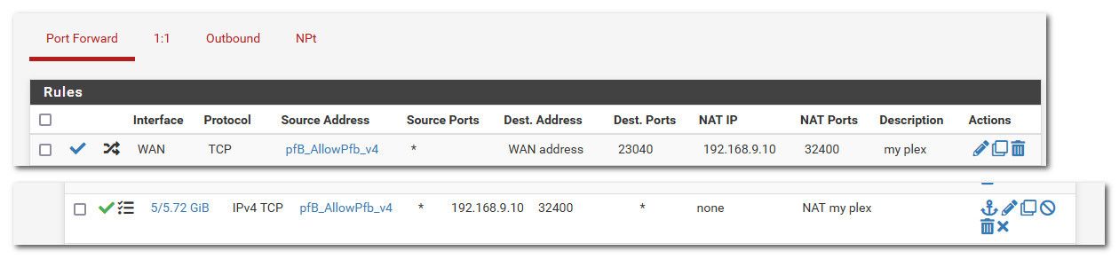

              • johnpozJ Online
                johnpoz LAYER 8 Global Moderator @killmasta93
                @killmasta93 don't do it that way... If all you want to allow is SAmerica, then allow that in your port forward.. ! rules can be problematic.. There is no reason to do it how your trying to do it, you want to allow SAmerica, then allow that - don't try blocking everything else..
                here is a port forward where I allow things to my plex. And the firewall rule it creates.

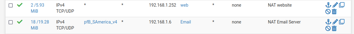

                  so i did the following created the NAT

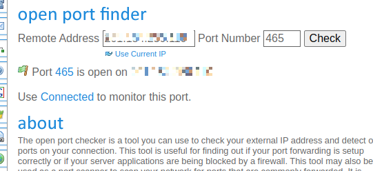

                  i recheck and it keeps showing the port opened

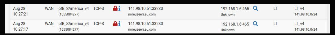

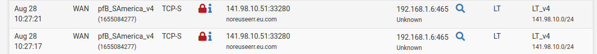

                  i was checking on the pfblocker it shows the packets being blocked but not really blocking

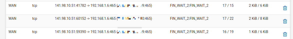

                  checking the states

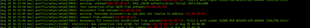

                  then i checked the postfix logs the 192.168.1.6
                  and it shows contact to the VM

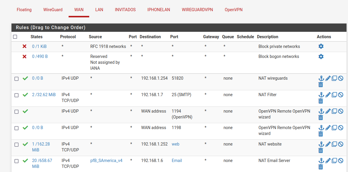

                    @killmasta93 and what do your firewall rules look like? Lets see your full wan rules, and you have zero rules on your floating.
                    What is this?
                    That is not firewall or log ? Do you have something in pfblocker creating auto rules?
                    Please post the full rule set of your wan.. You have something above allowing??

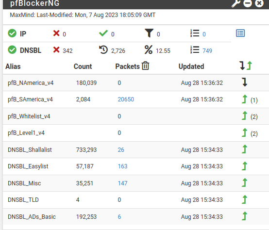

                      the photo that you attach is the log of pfBlocker showing that IP getting blocked but in reality its not blocking
                      pfblocker alias native

                          Thanks for the reply so deleted those rules
                          but still the same issue
