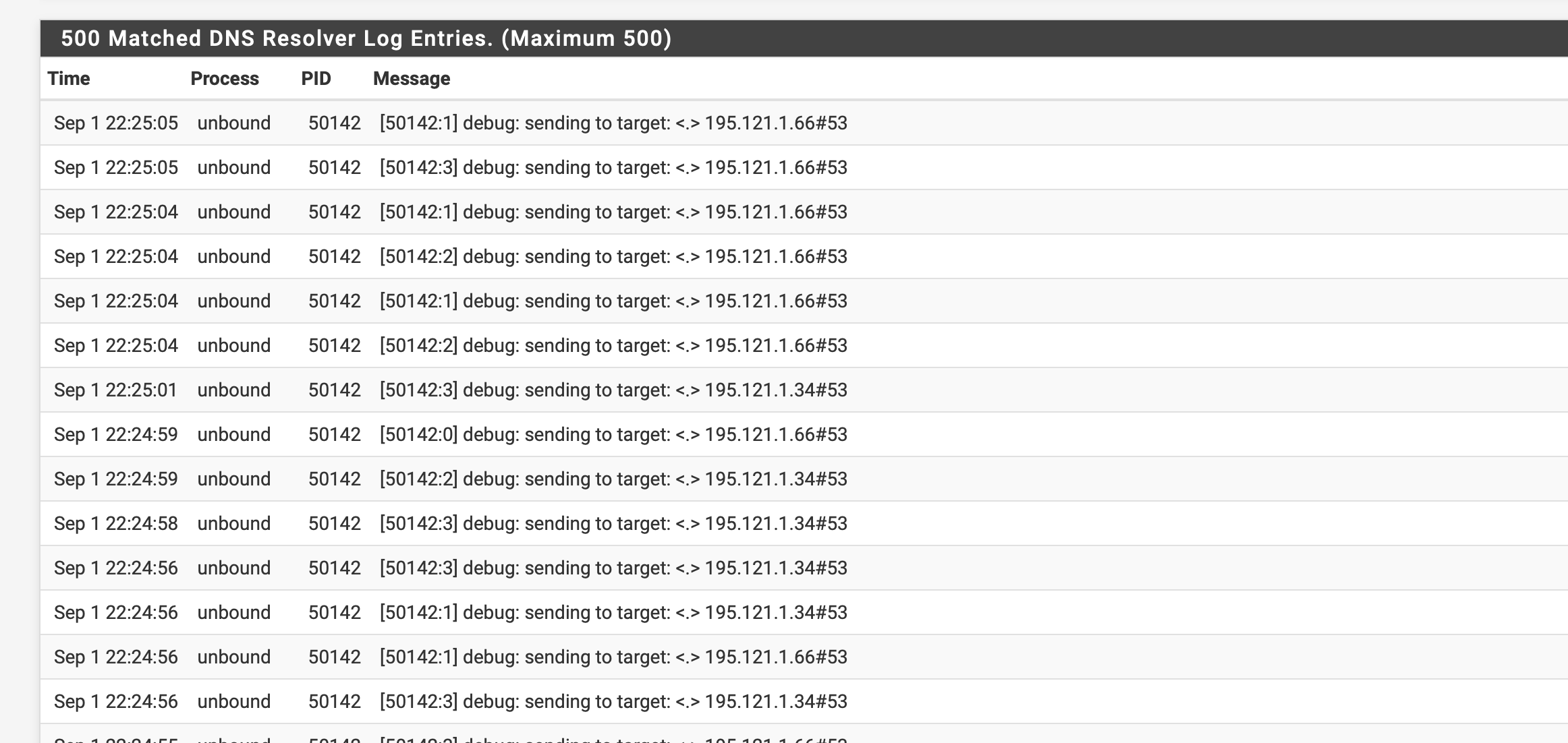

      I enabled logging for Unbound and I noticed that Unbound is not using the IPv6 DNS servers. Based on the logs it shows only IPv4 is addressed while there are also 2 IPv6 servers enabled.

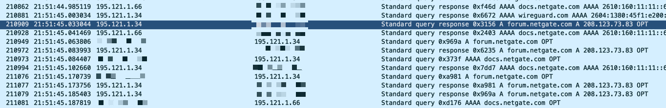

      When doing a packet capture on the WAN (PPPoE + DHCPv6) it shows up that the Unbound log is correct, none IPv6 dns request is made.

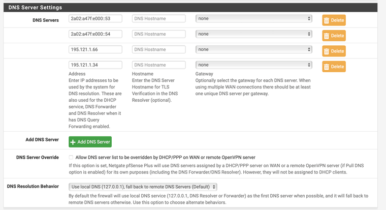

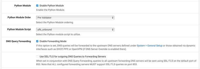

      Unbound config:
      DNS upstream

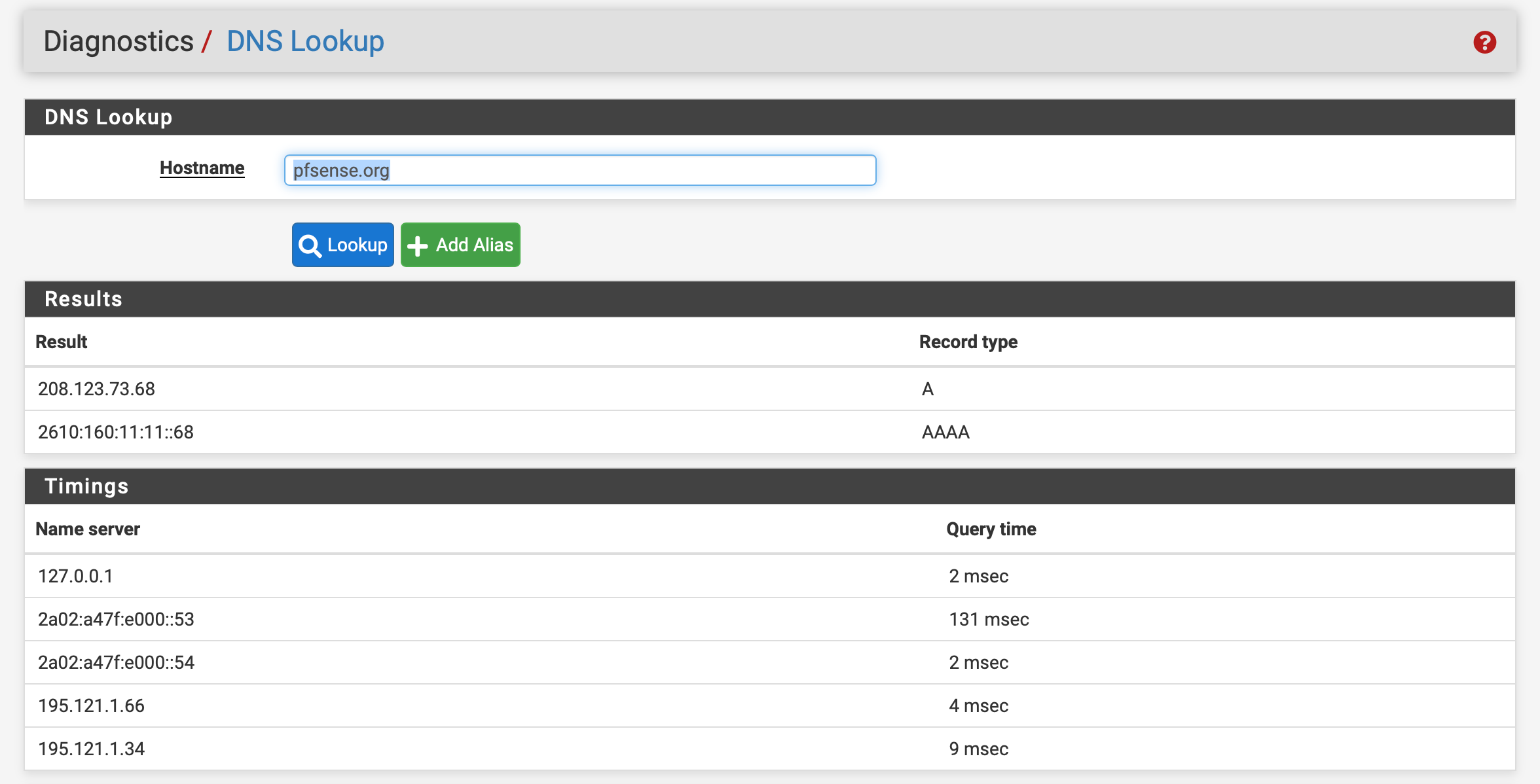

        Might be more relevant, Unbound is only addressing IPv4 from the running process.
        While doing a test from the pfSense GUI it works fine.

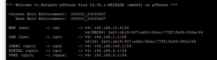

          Yo should be able to see it here :
          and here :
          You have checked the first box here ?

          You saw my images : there are two types of IPv6 addresses : the one starting with a "2" and the one starting with a "f".
          For me, the "f" one is valid locally, between my pfSense WAN and the upstream ISP router.
          I've also a "2" (GUA) on my WAN.

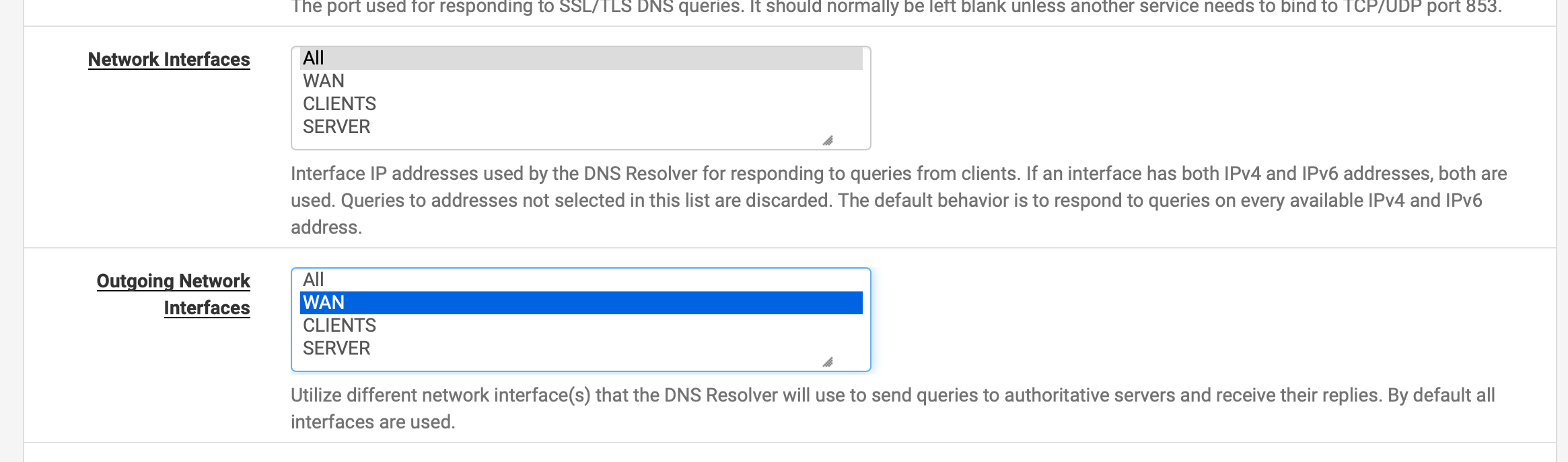

            • T Offline
              thebear @Gertjan

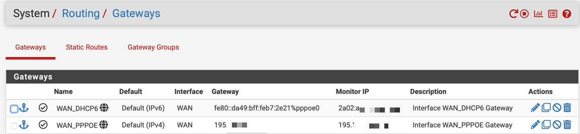

              @Gertjan thanks well as stated my ISP KPN (I think we live in the same country) does not provide a WAN IPv6 address, only a link-local address in the gateway overview (FE80) and over that link to the POP/Core the DHCPv6-PD prefixes are requested for my LAN interfaces. The 99:1 link is a test link, just to give pfSense a physical static IPv6 address, and it shows up that this test interface is selected for local sourced IPv6 traffic from the pfSense/FreeBSD kernel.
              @johnpoz indeed no GUA so I think Unbound doesn't see this link as a valid IPv6 exit point. Which might be causing the behavior we see. I prefer to have IPv6 native, IPv4 is nice to have ;-)
              I'll post my gateway screenshot when having access to the box tonight.
              johnpozJ GertjanG 2 Replies Last reply Reply Quote 0

                • T Offline
                  thebear @johnpoz
                  @johnpoz Indeed no need for IPv6 and thats why there might be more chance a bug is in place, les testers ;-)
                  The box is able to ping to ipv6.google.com showed from the first post's selecting a random LAN port where DHCPv6-PD has assigned an address too.
                  Gateway indeed only showing a link-local address. No IPv6 address on the WAN side.

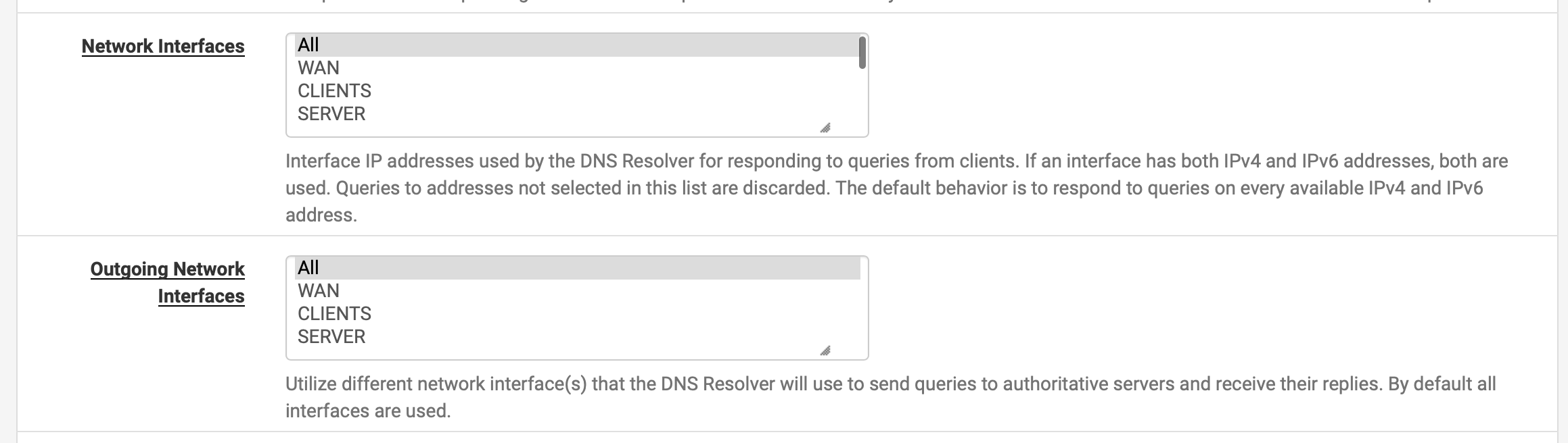

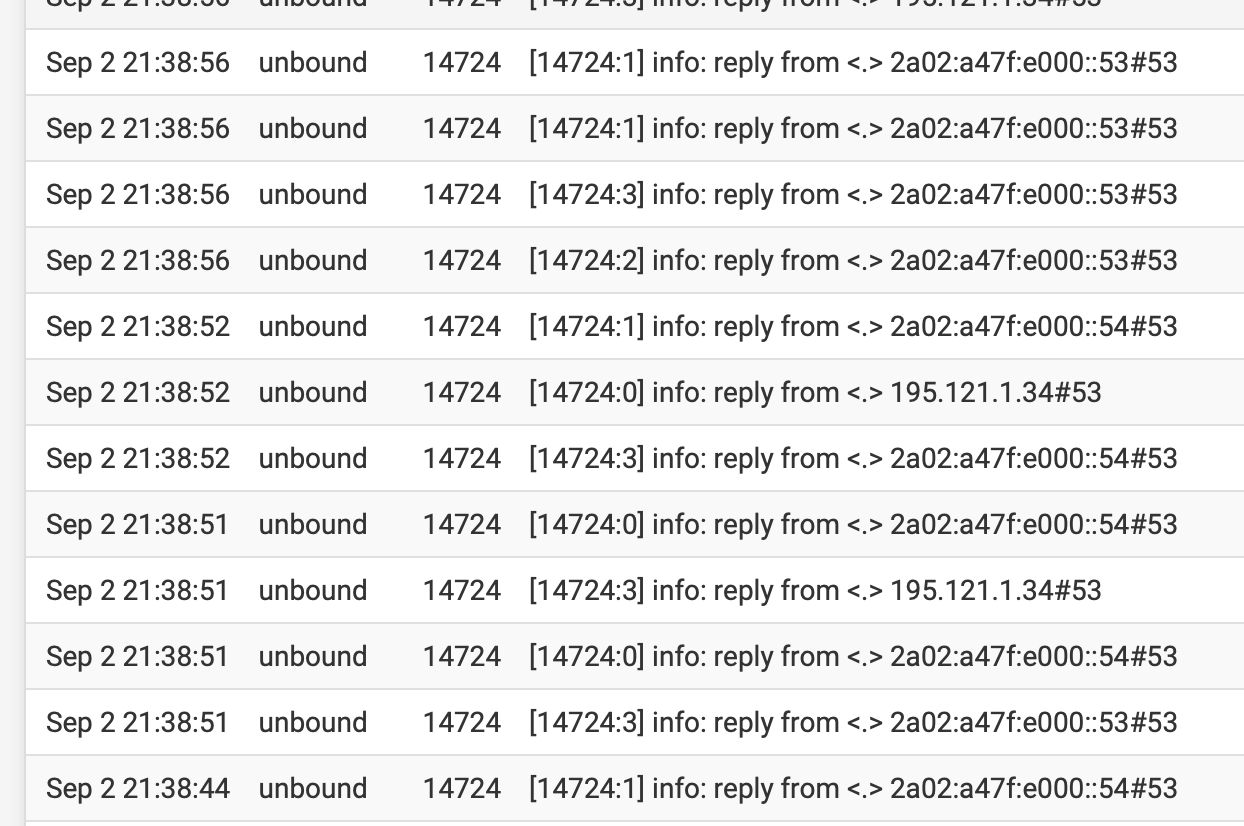

                  Changed to:
                  After the change of the outgoing interface to ALL it seems to started working. Thanks @johnpoz appreciated your tip.
