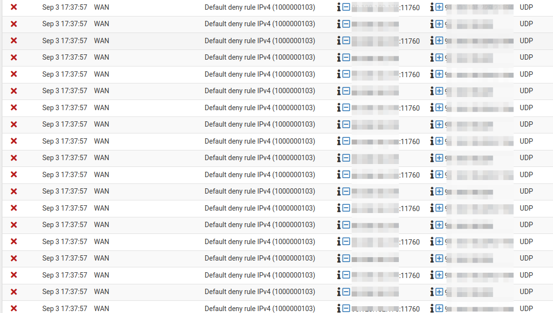

      I had tonzz of deny's on my home wan interface , source = summerhouse ip , dest = home ip , some just showing udp , others showing summerhouse ip (source) + source port + udp & dest = home ip + (ovenvpn port) + udp ????.
      When i stopped the VLC stream , the WAN deny's stopped too.

      So i did a packet trace on "home wan" , and some of the packets were reported as "too big" , which (for me) actually was kind of expected...

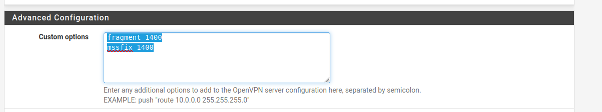

      I added this to both ends of my openvpn L2L ... You'd better do it on the remote end first , as they have to match.
      fragment 1400
      mssfix 1400
      Now the WAN deny's were gone , and i could see the video stream.

      I had to test .... Same WAN Deny's , and no video stream if i remove the 1500byte MUT on WAN , and the 1400byte "openVPN" mtu stuf.
      I have now reapplied the openVPN fix ... Aaannnd i have picture.
      Edit: The 1400 MSS size for openVPN, was selected "emperically" ... Could prob be higher ....
