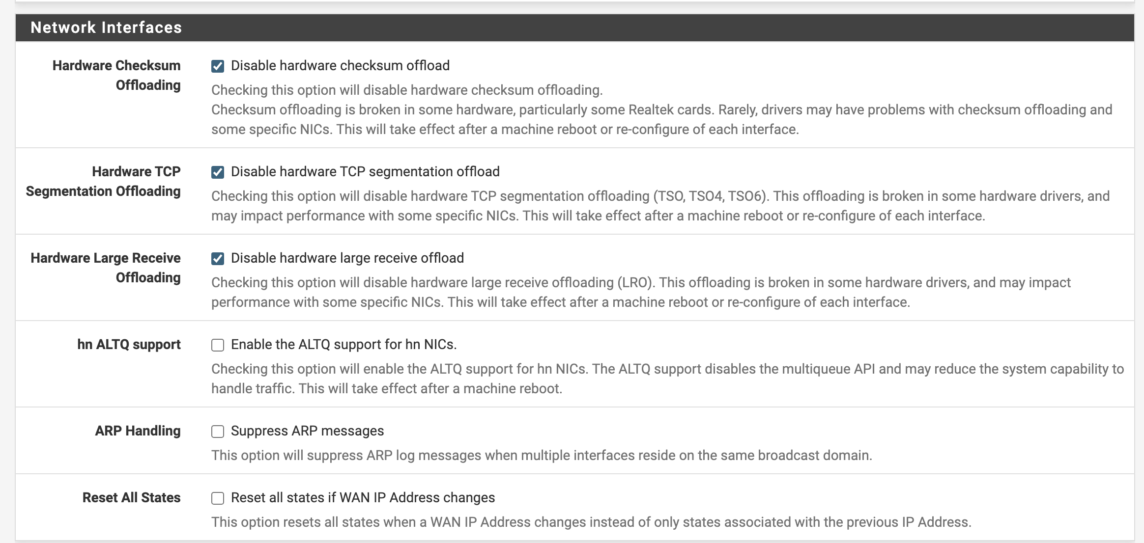

      @stephenw10 Sorry for the late reply. Life got a bit crazy there for a moment. I have tried a different switch in-between the Pfsense box and the ONT. Unfortunately I got the same result. What be the next step for support at this time since we seem to have exhausted our abilities here? Should we look into purchasing support from negate on this, or do you think that there is nothing that can be done at this time?

        Both the 1100 and 4100 have interfaces with quirks that could be causing issues here. If you can I would try connecting a very generic pfSense CE install to see if that also behaves the same. Some hardware with Intel NICs if you have it.
        Reading back I was almost sure it was going to be that ARP timeout value You could try setting that to something very low like 60.
          What about offboarding?????

            The default settings on the 1100 and 4100 should be fine there. Hard to imagine that preventing ARP. But easy to test...

              @stephenw10 I will try both of these things as soon as I am able, but that probably won't be until Sunday.
              • Austin 0A Offline
                Austin 0
                Thank you both for the suggestions. Unfortunately, I got the same result after trying both suggestions. I did notice that if I unplug, and then replug the cable the interface comes back online for a while, but eventually does go offline again. I do not have any other hardware to test with atm.
