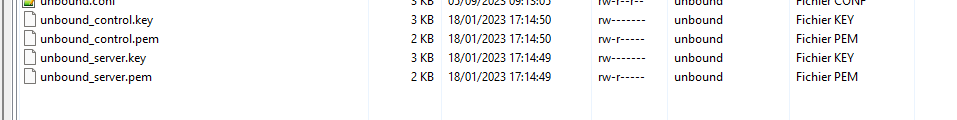

          I thought they were re created on every restart ? Reboot ?
          Guess not :
          => noop : 18/01/2023 wasn't the last time my unbound restarted ๐Ÿ˜Š
          Dono what I was doing at January 18, 2023.
          delete (rm) them most probably will re created them.

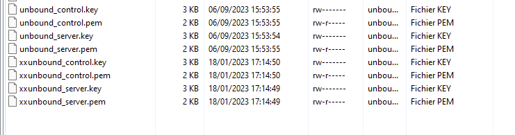

              If tested that :
              I renamed the for files :
              On the dashboard, I've stopped unbound.
              5 seconds waiitng ...
              I've started unbound :
              I found :
              Look at the four new files : the time stamp was from 5 minutes ago, they were all re generated.
