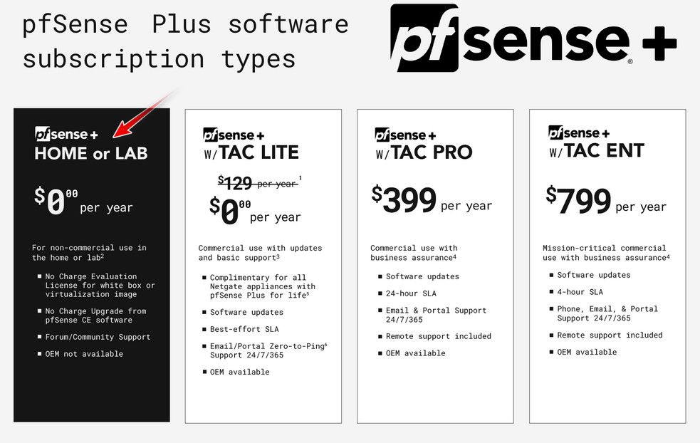

            What ever at this moment I am using 2.7 community edition. As private user I could upgrade to the ^professional branch^, I think I all ready have that license, but I hesitate because:
            • the CE-development branch used to be the most advanced / the newest branch
            • and I am not 100% sure that I can go back from ^professional branch^ to ^CE-branch^ in the future
            But:
            • I like the boot / snapshot function
            • this "mac-function^ (if it is really working yet)
            • and I noticed that development seems to be switched from CE-first to ^professional branch^ first (at least that is my feeling)

                          • johnpozJ
                            johnpoz LAYER 8 Global Moderator @JKnott
                            @JKnott
                            https://docs.netgate.com/pfsense/en/latest/firewall/ethernet-rules.html#ethernet-layer-2-rules
                            pfSense® Plus software versions 23.05 and later include support for rule-based pass/block filtering of packets based on Ethernet (Layer 2) header attributes.
                            If you want to play with it, get the FREE + home license..
                            https://shop.netgate.com/products/pfsense-software-subscription
