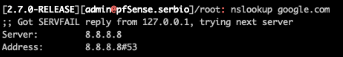

      I have my ISP router and PFsense firewall communicate over the 192.168.110.0/24 network and i have a local Lan of 192.168.0.1/24 with the pfsense firewall having the ip of 192.168.0.1 on the lan and 192.168.110.1 on the wan.
      I changed ISP and setup the new ISPs router to 192.168.110.2 and all works as expected on some devices but i was unable to access the internet from other devices. I found the issue was that any device not using with google DNS server set as static were unable to resolve domain names. Most devices on my network use DHCP and are given the pfsense as DNS server as that will filter out adverts with pfblockerng and allow local lookups. I restarted unbound and pfblockerng on the pfsense but issue still remains I also restarted the pfsense server and the issue still remains.
      I changed the DHCP setting in pfsense to use googles DNS but this means I am not no longer able to resolve local DNS names and see ads everywhere.
      Nothing was changed on the pfsense side so I have no idea what could be the cause or even how to debug this and never had the issue before when i changed ISP or router.
      I am still able to resolve local names with pfsense just not remote domains.

      Doing a DNS lookup on the pfsense i can see i get a fail from the local host but it is able to resolve domains using google DNS. From the main pfsense page i can see the dns servers listed are:
      127.0.0.1
      8.8.8.8
      8.8.4.4
      I assume the localhost address is normal to be there.

        I figured it out on the ISP router when i go into export mode there is a secure DNS option if i disable this all works as expected again

          Still, this is pretty strange ( imho : alarming ) :
          On your pfSense, no one answers on 127.0.0.1, that's not 'normal' at all.
          You told pfSense that these are there :
          @swansense said in ISP change and now pfsense unable to resolve DNS names:
          127.0.0.1
          8.8.8.8
          8.8.4.4
          is unbound running ?
          While you are at the command line :
          ps ax | grep 'unbound'
          and
          sockstat | grep '53'
          will tell you what you need to know.
