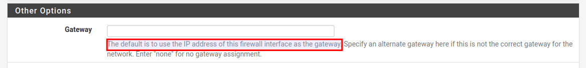

        Upon checking the DHCP server settings in pfSense, I'm not seeing where 10.0.0.1 as router/gateway (Option 3) is set anywhere which makes me wonder how DHCP figures out 10.0.0.1 in the first place? I guess it's using the IP of the LAN interface?

          On the DHCP Server settings, this is the Opt3 settings
          I have no idea if Opt3 would be suppressed of the fwall has no valid gateway.

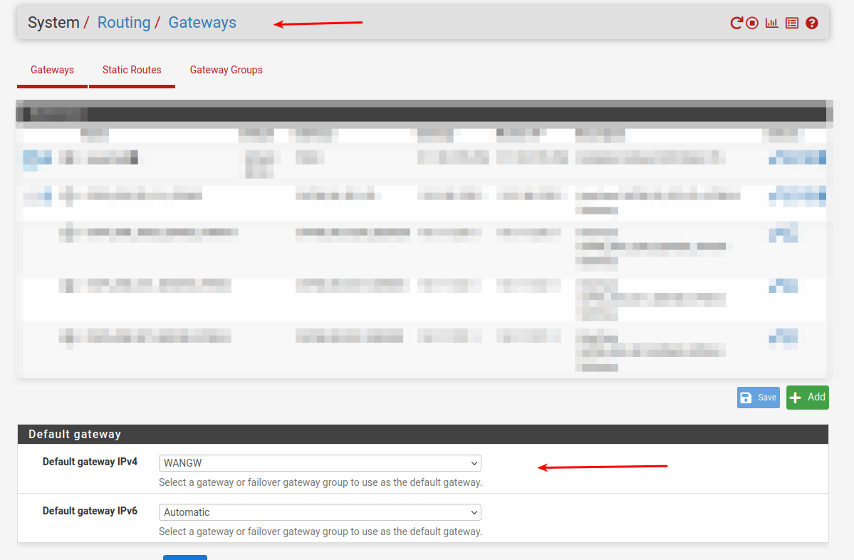

          That said , you might want to goto system --> routing , and force def-gw to the WAN-GW (bottom)
          Leaving that one "default".
          Was once biting my "behind" hard, as it due to a small "glitch" on WAN , decided to use the "next" gateway .... And not switching back, when WAN came back.

            2. In the DHCP server setting, manually set the Gateway IP to 10.0.0.1. This works
              Result: DHCP contains Option (3) (for sure since it's hardcoded)
            3. Set the Default Gateway to WAN.
              Result: Doesn't Help. Even worse, after getting the 65.x.x.x IP, pfSense does not have default route table item, thus cannot ping any public IP. Restarting the interface works.
