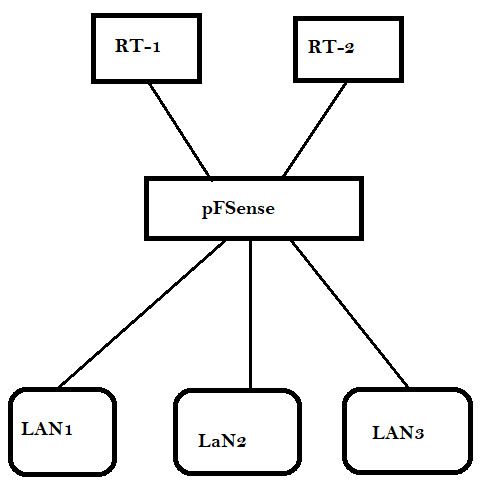

I have a psense server with 2 internet routers working in failover but now I need to do a port forward from RT1 to LAN host but I cant get it
I need to get access from RT1 to LAN2 host, in RT1 I have the net 192.168.1.0 and my LAN is 10.0.0.0 the RT1 is connected to pfSense and LAN nic to switch from pfsense
What rule do I need to do for accessing from RT1 to LAN2 host in rules?

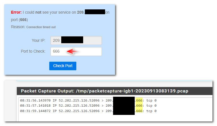

First thing I would suggest in any port forwarding troubleshooting is validate the traffic actually gets to pfsense wan. Pfsense can not forward what it never sees.
Go to like can you see me . org - sniff on the wan interface of pfsense and send some traffic..
Here simple test that takes 10 seconds. Sent a port, don't even have it forwarded or anything but can see that it actually gets to pfsense wan.

So how would you expect pfsense to forward something that never gets to pfsense?
Either you don't have the forward setup correctly in the router in front of pfsense, or the traffic is never even getting to that router for it to forward.. You sure when you went to can you see me that the IP it sent the traffic too was the routers wan IP that you setup the forward to pfsense wan IP?
