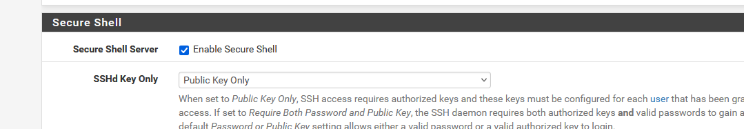

                    Still, this doesn't work for me, as I'm using this :
                    so no root (admin) password is asked, but a key passphrase is needed.
