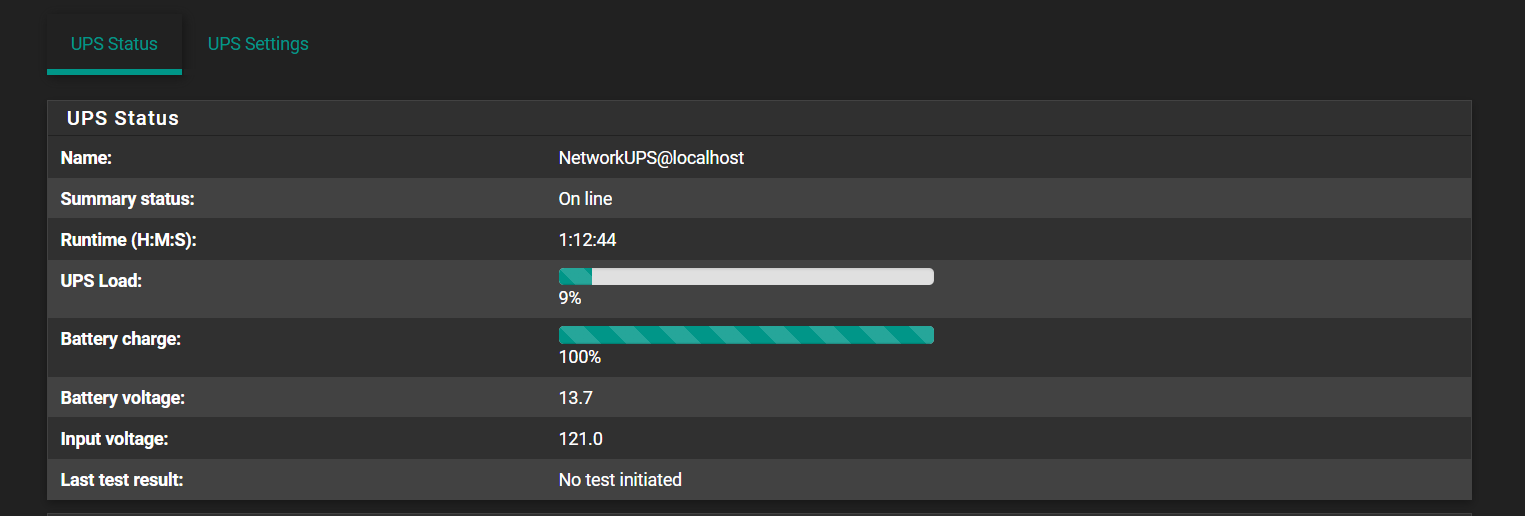

          I now have my UPS being seen:
          now that it is working, will graceful shutdown be automatic in the event of power loss due to this attribute?

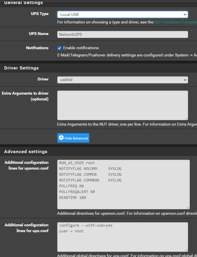

                these s the only settings i added:
                • dennypageD Offline
                  dennypage @garjaxon
                  @garjaxon Yea, I would get rid of all of it except possibly for the
                  user = root
                  in ups.conf. But test to see if you actually need it.
                  The RUN_AS_USER in upsmon.conf will be needed if you want smtp notifications in the current version of pfSense, but should not be needed when the next major version of pfSense is released.
                  • G Offline
                    garjaxon
                    lol yeah, @dennypage with just that it still works.
