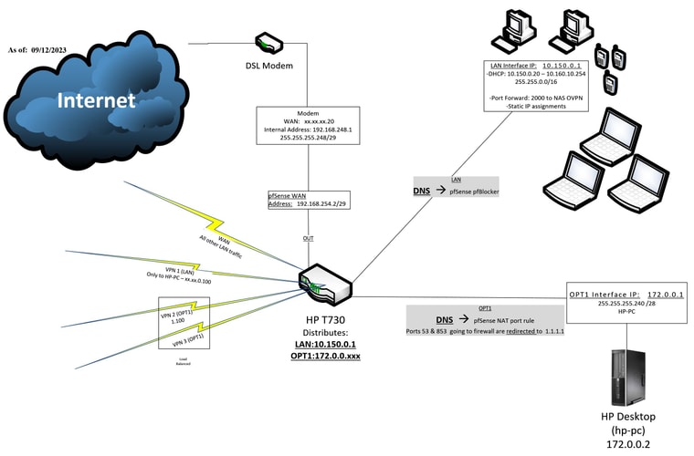

      Network Diagram Home-2023.09.12--outside viewing-V2.2.3_Smaller-Reddit.jpg https://imgur.com/oQtZo3e

          For the OpenVPN instances 'on' the OPT1 (igb2) interface, I believe the only thing would be the 'firewall rules' gateway field that set the OpenVPN tunnel for all of OPT1's traffic(except a few specific ports, directed to individual clients on the LAN interface).
          Each of the tunnel clients are created on the WAN interface only (I assume not related: I do have a OpenVPN server created on a unique port from the tunnels).
          igb2 is hard-lined directly to pc1. For whichever reason, for PC1 to be WOL ready when PC1 is powering down it completely cuts power to the link, but reactivates link power 10+ seconds later; PC1 then can successfully power-up from WOL packets. I know it is unusual behaviour for PC1's NIC, but it is not the pfsense system as a different PC that was in PC1's place before did not do this.
          OPT1 is static IPv4 only (no IPV6, IPV6=None), no upstream gateway.
