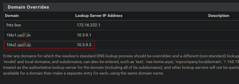

      I have 3 sites with pfSense's, one is home (site1). I have created Domain Overrides between site 1 & 2 and vice versa, works fine. Now I did the same between 1 & 3 but it is only working towards 1, not the other way around. The settings are the same. Site 3 is a clone (vm) of site 2. I changed the IP-addresses and over ip everything is working, just the Domain Override towards site 3 is not.

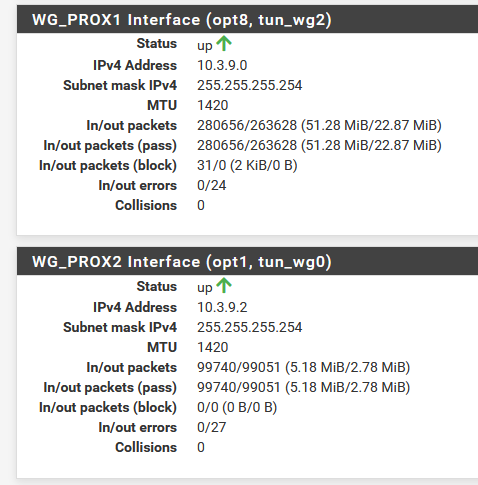

            These 10.3.9.x IPs - where are they exactly - what interface are you talking them on? Does this pfsense have a leg in the 10.3.9 network?
              It (home) does have in both of these pfSenses.

                  In hindsight obvious but I had limited the Outgoing Network Interfaces for the resolver and the interface to Site 2 wasn't in it. 😬

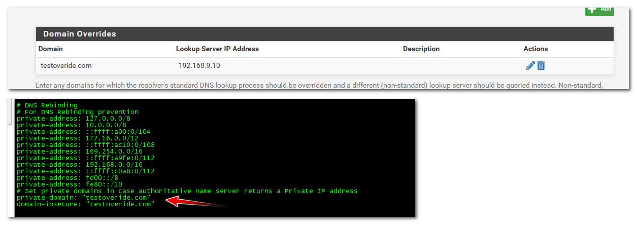

                    https://docs.netgate.com/pfsense/en/latest/services/dns/rebinding.html#dns-resolver
                    edit: it seems these are now set automatically in unbound when you create a domain override. Not exactly sure when that might of changed? I don't believe its always been like that.. But it a good setting to keep users from shooting themselves in the foot.

                    [23.05.1-RELEASE][admin@sg4860.local.lan]/: cat /var/unbound/unbound.conf
                    Bob.DigB 1 Reply Last reply Reply Quote 1
