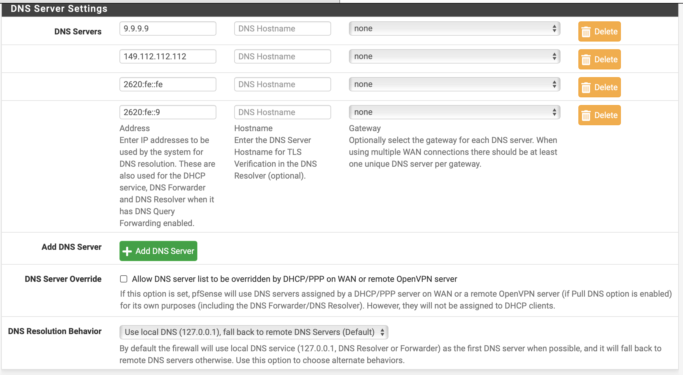

                                    What is the DNS behaviour setting in General Setup?
                                    • E Offline
                                      elvisimprsntr @stephenw10
                                      @stephenw10 said in Unable to update repository pfSense:
                                      Are clients, which can resolve, using pfSense for DNS or being passed quad9 to use directly?
                                      Client are served pfSense LAN IP address
                                        Hmm, and Diag > DNS Lookup just fails for all configured severs? For any fqdn?
