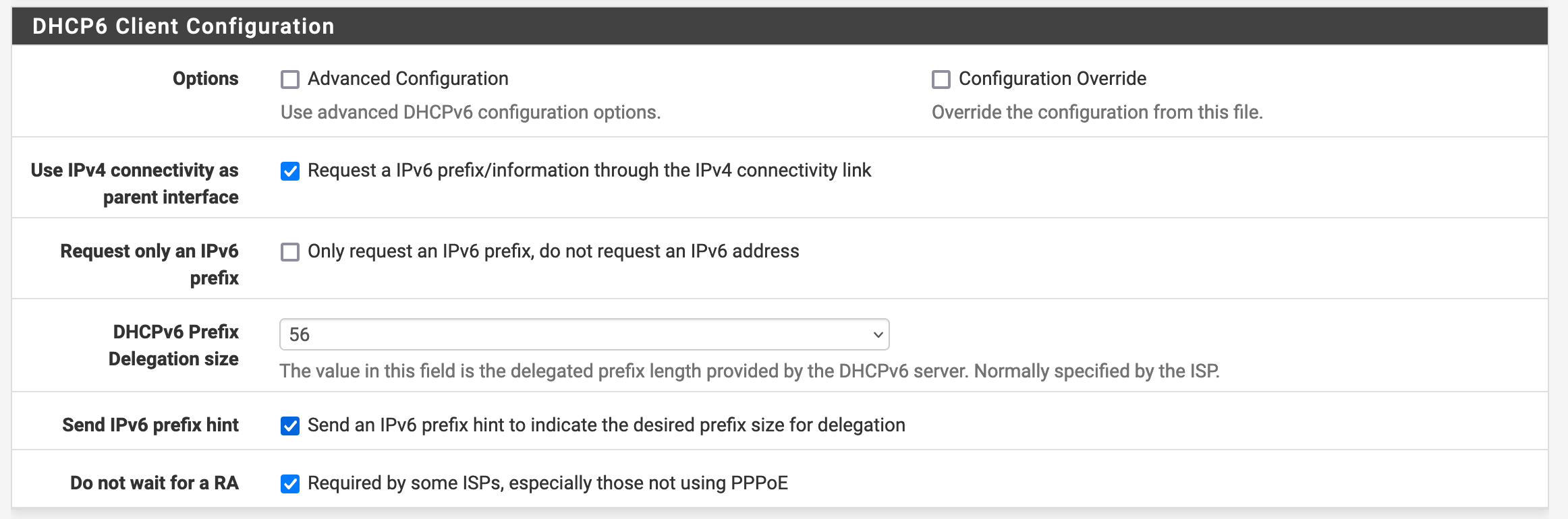

      After a bit of trial and error, I managed to get IPv6 working with Sky Broadband. For anyone else looking with Sky Broadband here is what worked for me:
      (Interfaces > WAN)
      In the WAN Interface config select DHCP6 as the IPv6 Configuration type:
      In the DHCP6 Client Configuration for the WAN interface tick the following options
      • Use IPv4 connectivity as parent interface
      • Send IPv6 prefix hint
      • Do not wait for a RA
      DHCPv6 Prefix Delegation size is a /56

        "DHCPv6 Prefix Delegation size is a /56" - it should probably be a /64 as seen on the delegated prefix on your LAN interface (2a02:c7c:xxxx:xxxx::/64). The ISP's device likely ignored your /56 PD request and gave you a /64.
          "Note: The delegated prefix in subnet should be a /64" - it shouldn't matter if you do not delegate prefix into subrouters (i.e. router connected to your LAN network). In this case you left LAN DHCPv6 server's prefix delegation range empty, and the PD size there doesn't do anything. Either way, if your ISP only gave you a single /64 you won't be able to further delegate it into routers behind your LAN (or you may but it will very likely break, and SLAAC won't work on prefix size smaller than /64).
          Sky hand out /56 prefixes, and as far as I am aware, and from the logs that is what it appears to assign to my router. (I have XXX out part of the subnet)

          I think the only critical options are among the following:
          • Interfaces > WAN > IPv6 Configuration Type > DHCP6
          • Send IPv6 prefix hint (can't even be sure of this, there might not be need to enable this)
          probably doesn't need to be set but why not hint what you want. Sky will probably ignore anything larger than a /56 but may give you what you want if you ask for smaller
            No, it should be 56, assuming that's what the ISP provides. That's the size you're requesting, which has nothing to do with your LAN, which is normally /64.
