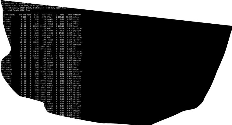

            Mmm, that doesn't use PHP directly though. So I assume it slows PHP significantly either by simply using system resources or because something php is trying to do on a large routing table in the gui is causing an issue. For the latter I would expect to see it on some pages only?

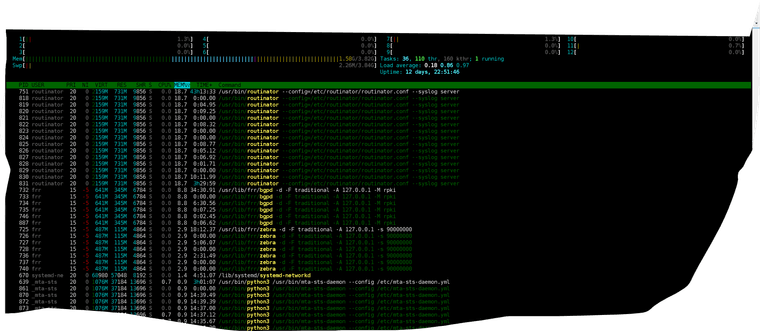

                this is frr running on linux ubuntu
                yon 0Y 1 Reply Last reply Reply Quote 0

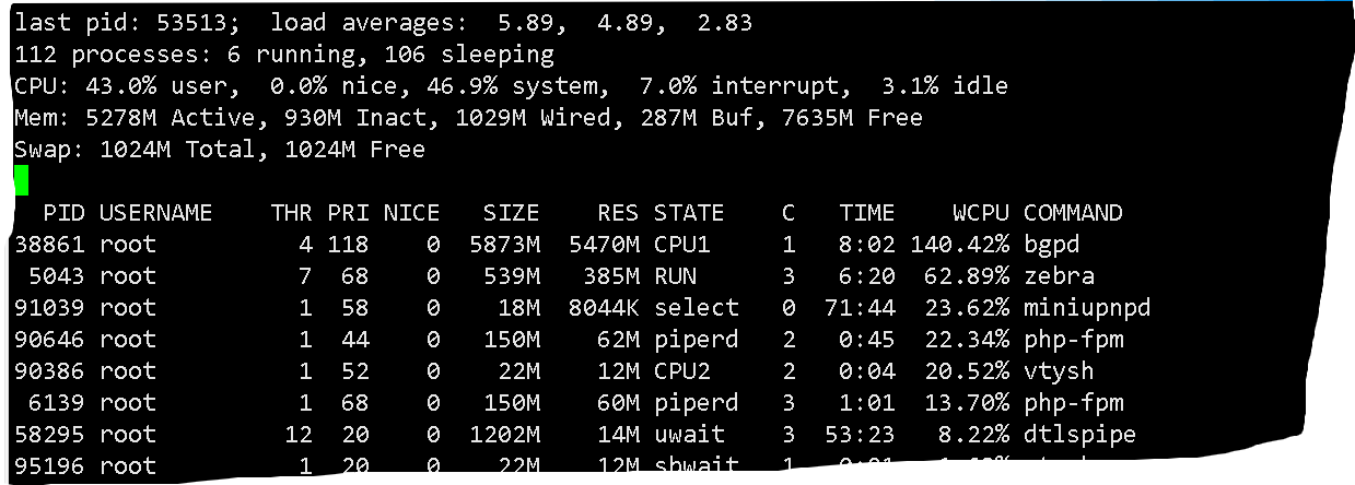

                  this is pfsense frr, This is what happens during low load conditions

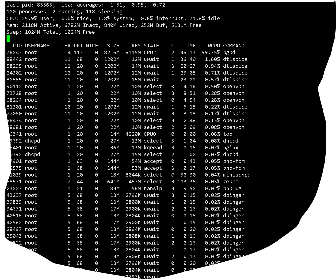

                    pfsense frr
                    9244784d-ea28-40e8-b270-e8be65c08f80-image.png @yon-0
                    • yon 0Y Offline
                      yon 0 @yon 0
                      The above is the current situation after I modified the php-fpm parameters, and php is basically running normally.
                      I also searched various resources on the Internet to analyze the results. I am not sure whether it is completely correct. I am just reporting the actual situation to see if it is correct.
                        OK, so the loading is all in zebra rather than in PHP directly. What is the total system loading when it's in that state?
                        yon 0Y 2 Replies Last reply Reply Quote 0
                        • yon 0Y Offline
                          yon 0 @stephenw10
                          But when accessing through a web page, php-fpm often encounters cpu 99.75% or 100%. This is especially obvious when visiting the following two pages:
                          /index.php /status_frr.php
                          If you select to display more routes through the page, the pfsense system crashes. When the frr route changes or is sorted, it will cause the pfsense system to crash. When the bgp and zabra process CPU reaches 100%, all web pages will be stuck and unable to work. php-fpm is 100% aslo. This dedicated server only runs pve and pfsense. When frr service is stopped, the web returns to normal.
