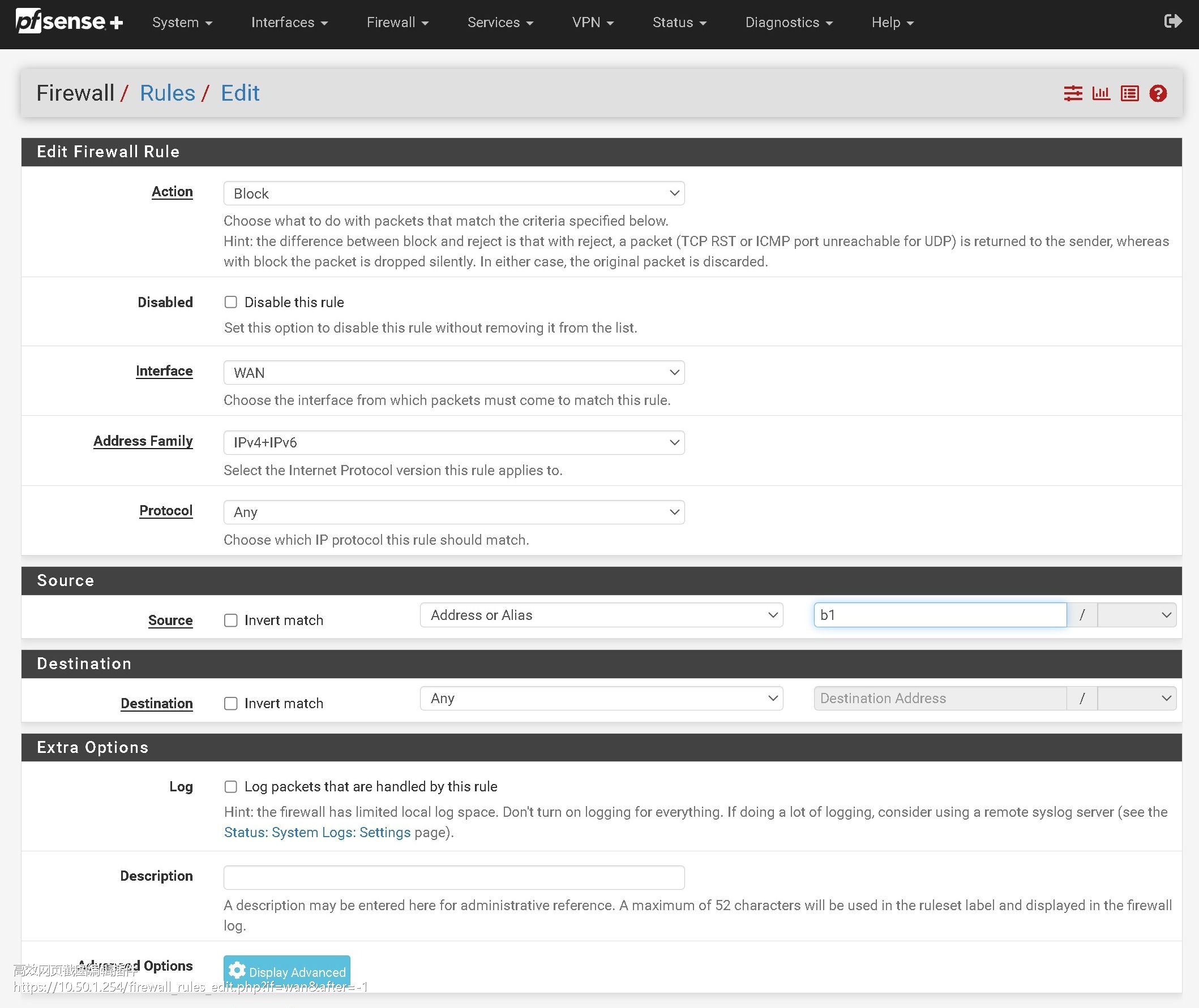

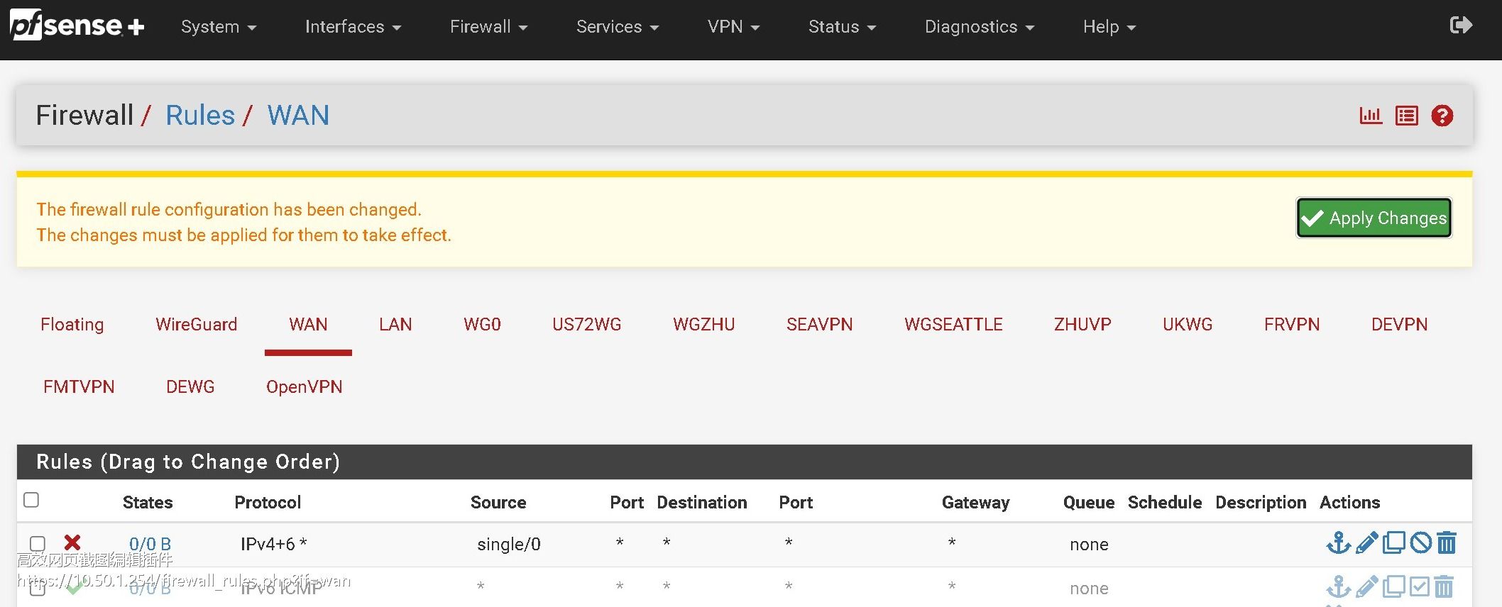

                stephenw10 Netgate Administrator @yon 0
                @yon-0 said in some services show can't start:
                i setup alias is b1, but show is single/0
                Ok, that is a bug I can easily replicate that.
                yon 0Y stephenw10S 2 Replies Last reply Reply Quote 0

                          stephenw10 Netgate Administrator @stephenw10
                          @stephenw10 said in some services show can't start:
                          https://redmine.pfsense.org/issues/14870
                          yon 0Y 2 Replies Last reply Reply Quote 0

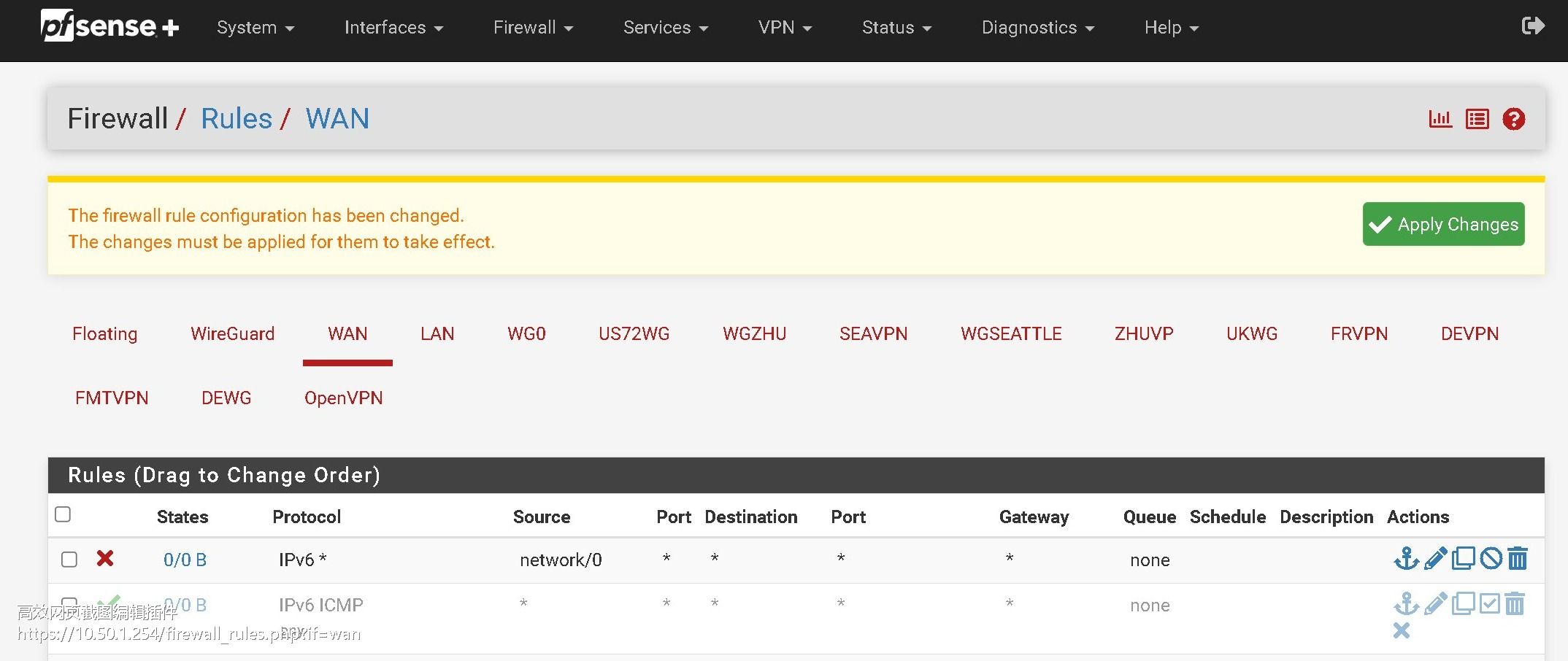

                            when i input network 2602:fed6:7021::/48, it is show network/0 in firewall rule
                              This should actually be fixed in todays build (23.09.b.20231013.0600) are you testing that?
                              Existing rules will need to be resaved to populate the aliases correctly.
                              johnpozJ yon 0Y 2 Replies Last reply Reply Quote 0
