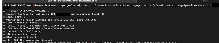

            I tried as suggested. I got an SSL timeout. Just to be sure, I tried www.google.com. That seems to work.
            Terminal Tests
            Just to make sure I'm hitting the right server, I did a quick DNS query. The IP addresses for freedns.afraig.org match.
            DNS Query
            Yes, the parent interface is OPT1. That's the interface tied to the WireGuard tunnel that goes to Hoppy that handles the port forwarding. I want the dynamic DNS to update to the Hoppy IP so that the services I expose have a friendly name.

                @toriol said in Dynamic DNS Update Not Working:
                Yep :
                The other side never answers.
                So, you can't reach 69.42.215.252 (port 443) using that interface.
                Can you ping it ?
                If so, there is no routing issue. and your request is blocked at the "afraid.org" gates ( using a using a VPN filter, which I can understand )
                If not : routing issue or tunnel not connected.
