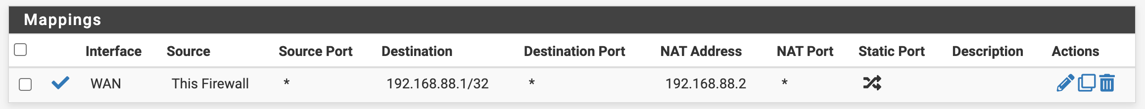

      I've created hybrid outbound rule:

            Yeah the VIP needs to have a subnet that includes the modem IP, like /24.
            The source address on your outbound NAT rule has to match where ever you;re trying to connect from. So probably 'LAN net'.
            'This Firewall' only includes IP addresses on the firewall itself not local subnets.

                Not for an IPAlias VIP on WAN. You would add one for each IP you want to use there and at least one them has to be defined with the correct subnet mask so the routes are added. Otherwise pfSense has no idea how to reach any other IP in the subnet.
                So you you just need to change your VIP on WAN to be 192.168.88.2/24.
                Then change the source in the outbound NAT rule to 'LAN net' so that traffic from clients in the LAN matches it.
