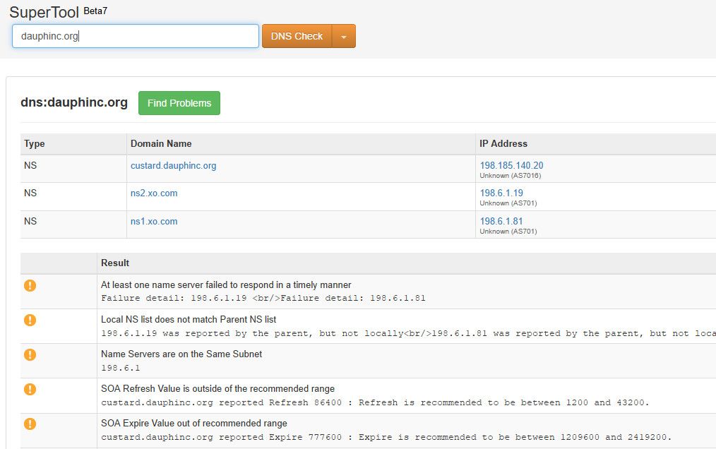

        You can see from here - their dns isn't very robust let us say..
        https://dnsviz.net/d/dauphinc.org/dnssec/
        I see a bunch of errors that should be corrected with their setup.
        Another dns testing site also shows a bunch of issues with it.
        https://mxtoolbox.com/SuperTool.aspx?action=dns%3adauphinc.org&run=toolpage
