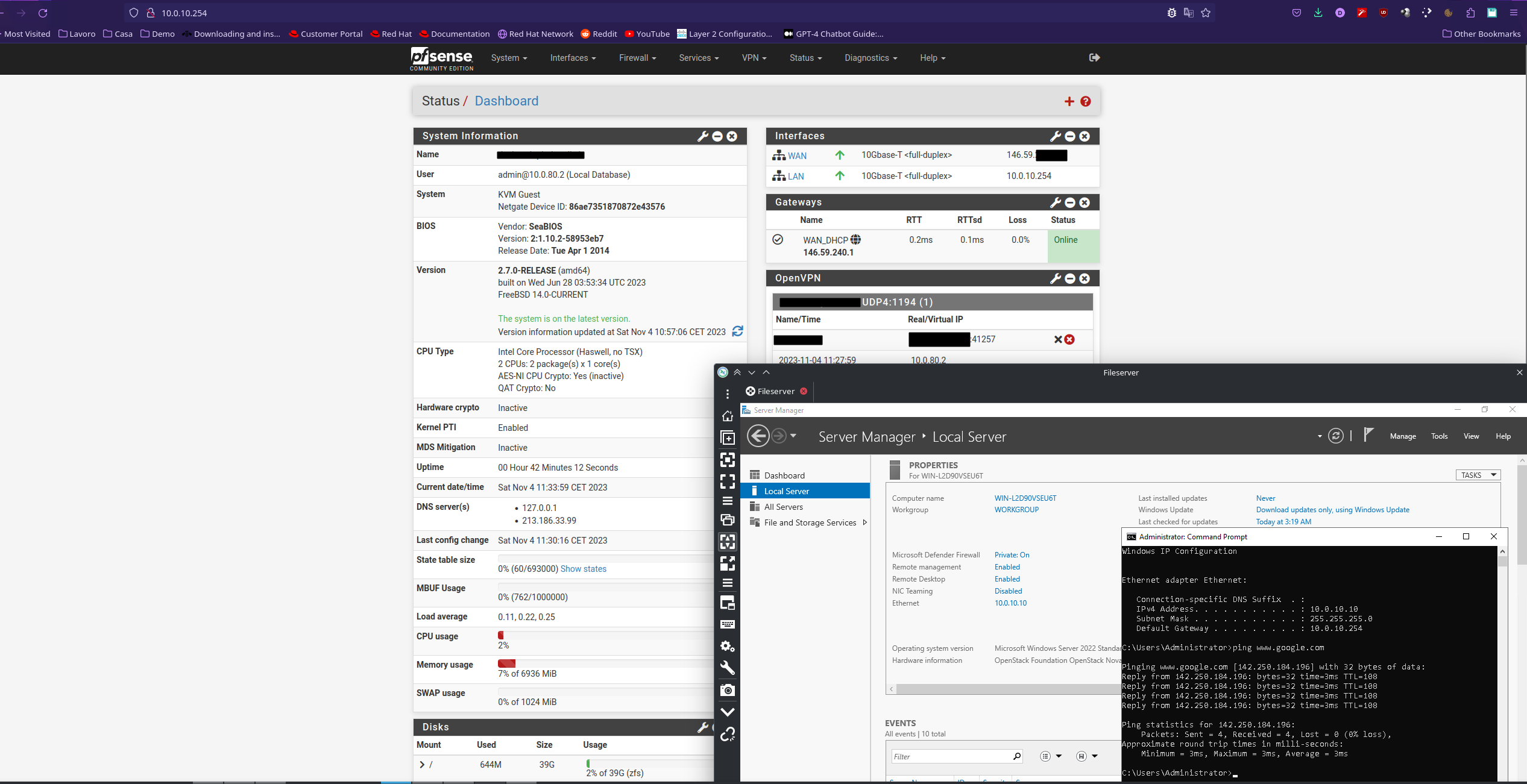

      0) firewall installed (by uploading a qcow2 image to the horizon ovh interface and booting it)
      1. apparently everything worked, we could get public connectivity, screenshot: 1_firewall_ok.png

      2. once we setup the networking on the windows vm everything seemed to be working, screenshots: 4_windows_server_ok.png and 4_everything_works.png

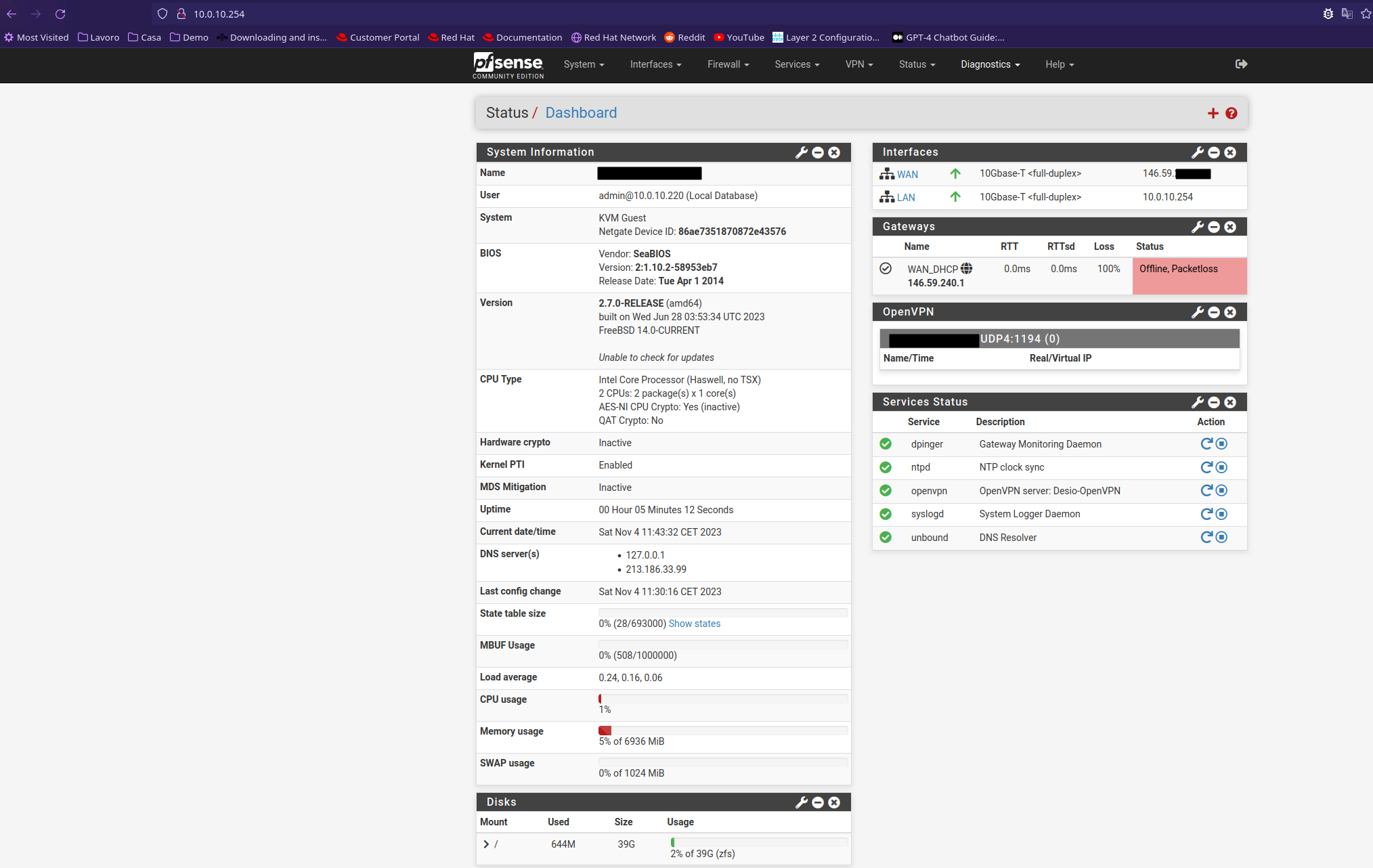

      3. we rebooted the firewall
      4. the firewall stopped working again, screenshot: 6_after_reboot.png, 6_firewall_not_ok, 6_arp_not_working, 6_ping_not_working_to_gateway.png
      5. we reassigned the interface on the pfsense cli, everything started to work again, screenshot: 7_after_interface_reassignment_or_dhcp_reconfigure.png, 7_arp_working.png
      6. after every reboot, consistently, the firewall gets a dhcp pack and it gets a gatewy pushed that way, but it cannot reach it until we either reconfigure the interface or reassign it, this doesn't work consistently, sometimes it has to be done multiple times before it works, if we just leave it there for some time (hours) it doesn't start to work on it's own.
