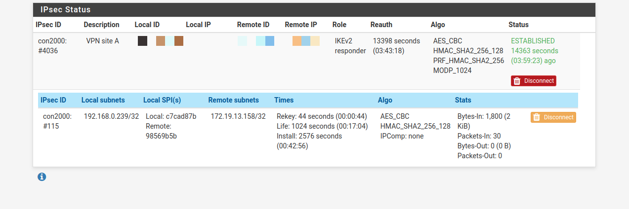

Currently we have pfSense as the server and the client is running fortigate, the issue is that the forti is not seeing my LAN ip 192.168.0.239 but the connection tunnel is connected.
I was have checked all firewall rules it seems to be correct but i keep getting CLOSED:SYN_SENT
These are the firewall
when the client tries to telnet 192.168.0.239 22 on thier side from 172.19.13.158 shows that issue the closed
Any ideas if its my issue or the fotigate issue?
Thank you
@killmasta93 have u try to run sniffer like tcpdump and see if u see that at least u get packets reaching the interface on pfsense side and the same on fortigate?
@periko hi thanks for the reply, i ended up just putting the IP of the fortigate WAN ip and NAT
