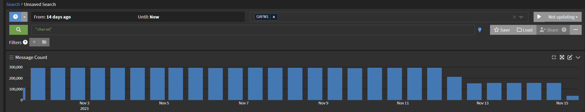

      Just upgraded to 23.09 on my boxes, and i noted a MASSIVE increase in my SIEM logging from IPSec in pfSense.
      After the upgrade all IPSec logging levels (under VPN -> IPSEC -> Advanced Settings) were returned to their defaults.
      Those levels are far to noisy for our setup, so I tried dialing some of them down, but changes are not respected (or saved). When ever i return to the log settings, they are at default, and the actual logging is also at default regardless of what I do.
      Can others confirm this behaviour?
