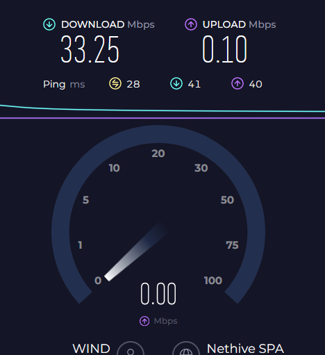

      I have PFsense+ 23.09 on bare hardware, sometimes my FWA main ISP fails so i am in need of a backup connection, with the help of @stephenw10 i got an old Huawei K5150 working but it's performance were awful, so i got a ZTE 4G router in which i got a 4G sim, gave the backup router the IP address 192.168.1.3 and set up failover in the gateway section so it looks like this: f342179c-c9ff-49a3-a3e8-199693677ffe-immagine.png,

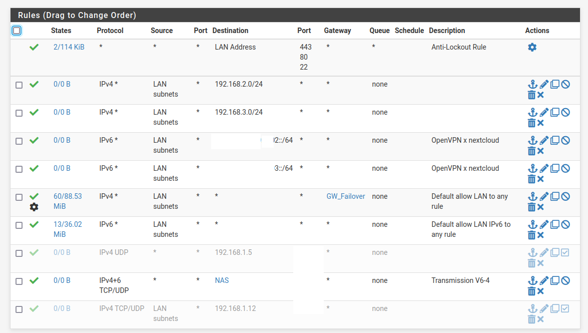

      then i changed the gateway in the firewall IPv4 LAN rule so it looks like this: cc104abd-b8fe-487d-b6eb-87ed69c97d3c-immagine.png
      and tried to see if it works and it does, but only in download... As soon as i try to do an upload test with the backup connection it fails or it finishes it with something like 0.03Mbps in upload while capping my 30Mbit download. (My SIM has a max speed of 30/30 and it can provide also IPv6, but keep it disabled because it create conflict with my main IPv6 and i think it also isn't static. Also if i try a test with the 4G router alone it goes 30/30) I don't understand why it behaves like that, somebody has suggestion of where to look?

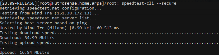

                I tried to reconfigure the GW-Failover as i did before, and it still behaves the same, but if i run a speedtest from the firewall it works just right...
                So i think it's something blocking traffic from LAN but i don't know what can be
