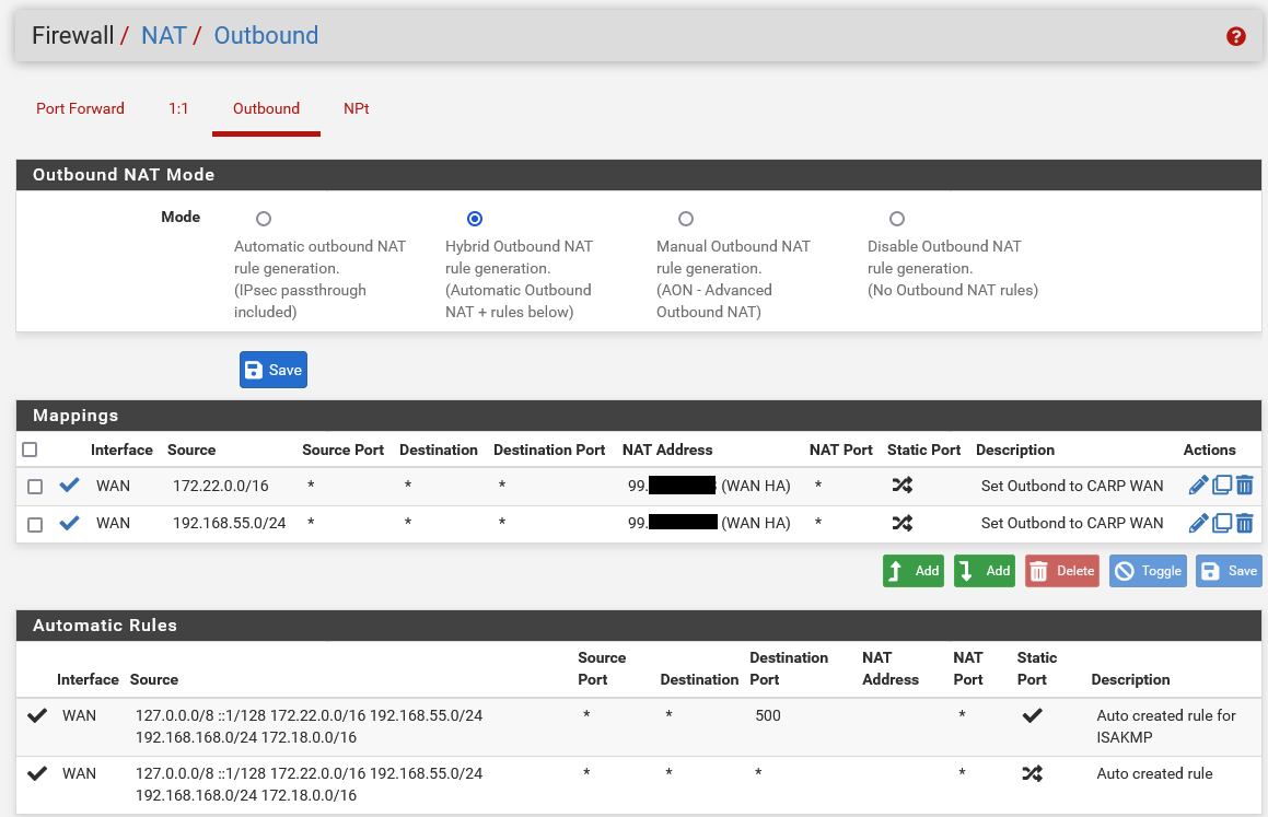

                                        @stephenw10 So after more testing the secondary node appears to be functioning normally. I then switch CARP to maintenance mode on primary node and proceeded with the upgrade of the primary node. The upgrade seemed to have gone well, I was even informed that my system is on the latest version. Next I preceded to check available packages. Unfortunately the list was empty. Trying to execute pkg-static -d update resulted in the page not refreshing, it seemed like the command hung.
                                        I checked that DNS was setup correctly and it is, I'm able to resolve names to IP addresses. Surprisingly, I can't ping google.ca. I checked that System > Routing > Default gateway
                                        is set to "WAMGW" and it was. I also tried rebooting the firewall, nothing changed.
                                          Does it have a default route present and correct in Diag > Routing?
                                          It's better to run pkg-static -d update at the actual command line if you can. That way you can see the partial output and any errors while it's running.
                                          • K Offline
                                            Kajetan321 @stephenw10
                                            The gateway IP is our ISP provided gateway. The same as on the secondary firewall.
