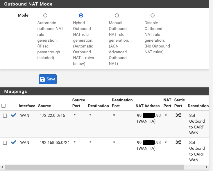

                                    My Outgoing rules look like this:
                                    Should I change the NAT address to the non VIP wan address?

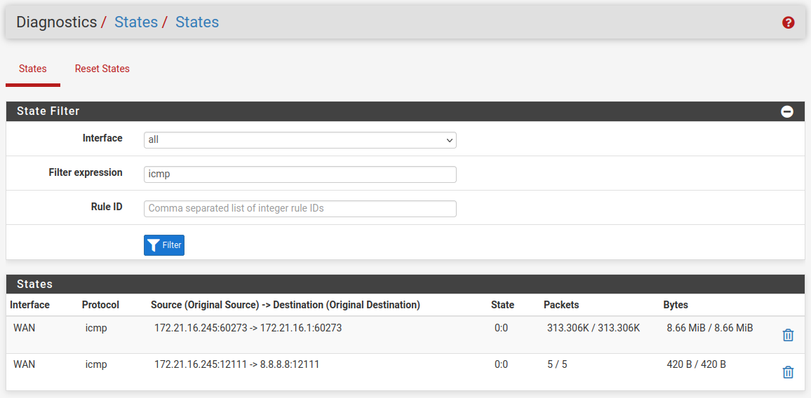

                                      That's the list of outbound NAT rules. And those look correct, neither of those rules should catch the traffic from the public WAN IPs.
                                      Check the state table in Diag > States. Pings should show as being from the WAN IP directly with no NAT like:
