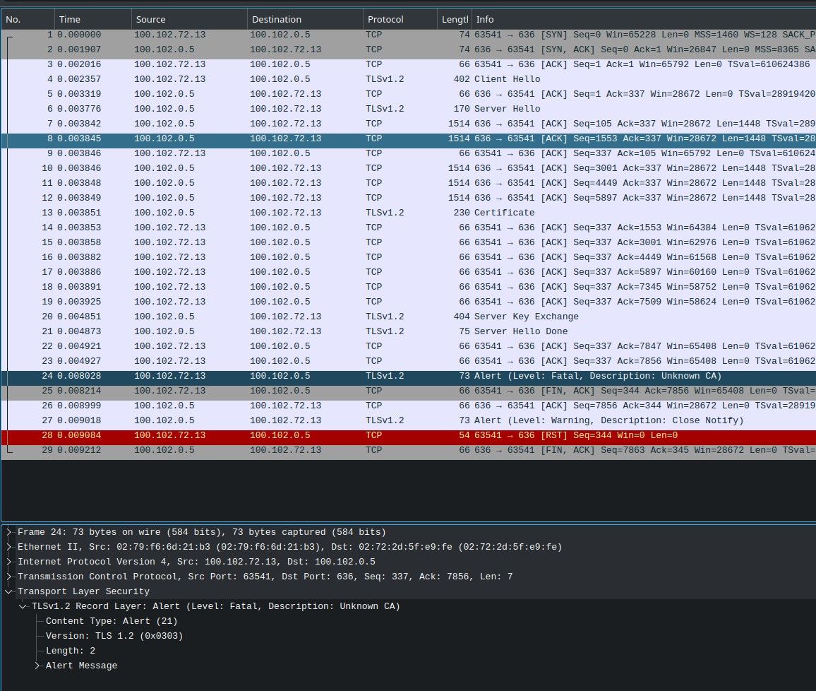

      This is my scenario:
      • brand new pfSense+ system deployed as AWS AMI (AMI ID: ami-0e1a56989ef6d9eb2, AMI Name: pfSense-plus-ec2-23.09-RELEASE-amd64 23-d6a66a49-ceec-4a27-ad5b-ea8a3eb55b15) with singe ENI and a EIP
      • 2 different ldap source configured in 2 different Authentication Servers:
        • Authentication Server #1 is an AWS Managed Microsoft AD, a NLB with a TLS Listener with certificate signed by our internal CA is configured in order to get LDAPS (see this AWS blog post for details)
        • Authentication Server #2 is the Okta LDAP interface of our preview tenant
        • LDAPS is in place for both Authentication Servers
        • Search scope, Authentication containers, Bind credentials, User naming attribute and Group Object Class differ between the 2 Authentication Servers
      Steps to reproduce the issue:
      • configure Authentication Server #1
      • Authentication Server #1 configuration successfully tested with Diagnostic > Authentication
      • configure Authentication Server #2
      • Authentication Server #2 configuration successfully tested with Diagnostic > Authentication
      • testing again Authentication Server #1 with Diagnostic > Authentication will fail with error "Could not bind to LDAP server Authentication Server #1"
      • delete Authentication Server #2
      • testing again Authentication Server #1 with Diagnostic -> Authentication will succeed
      The issue is reboot resistant.
      I suspect the following
      • pfSense+ system is somewhere messing up Bind Credentials and/or Certificate validation
      • issue is agnostic to database engine
      I'm unable to run test without TLS/SSL configuration because of the scenario: could anyone reproduce the issue, maybe without LDAPS configuration also in order to understand the root cause?

        Update: I run Packet capture and it seems a random failure on CA verification on both Authentication Server:
