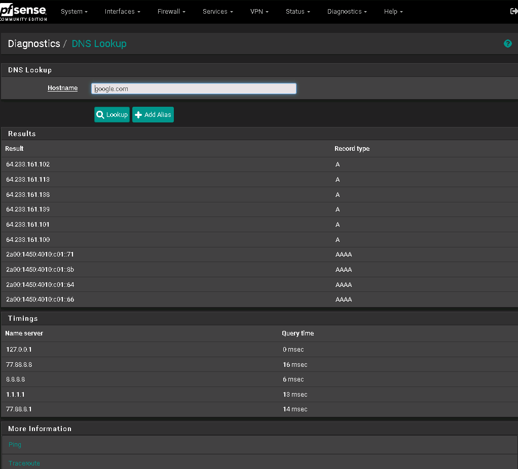

            JohnDow @Gertjan
            @Gertjan said in strange unbound issue:
            his means : unbound isn't running (or brain dead).
            it work in all other sites
            but **all other work and resolve**.
            in second pics resolve google

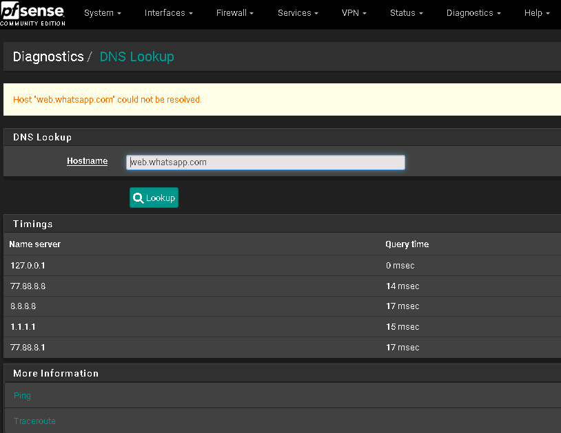

            until update 2.7.1 unbound work perfectly.
            0 ms but not resolve only web.whatsapp.com
              Gertjan @JohnDow
              @JohnDow said in strange unbound issue:
              For whatever reason, your "Results" part is missing.
              unbound, this time, replied within "0 ms", the others within 17 ms.
              But no answer - for you. I did have an answer.
              That for you, 8.8.8.8 hasn't an answer neither .... that's puzzling.
              If I ask "8.8.8.8" manually :
              [23.09-RELEASE][root@pfSense.bhf.tld]/root: dig @8.8.8.8 web.whatsapp.com +short
              mmx-ds.cdn.whatsapp.net.
              31.13.83.51
              Try this one for yourself.
              Can you also show a :
              dig web.whatsapp.com
              J 2 Replies Last reply Reply Quote 0

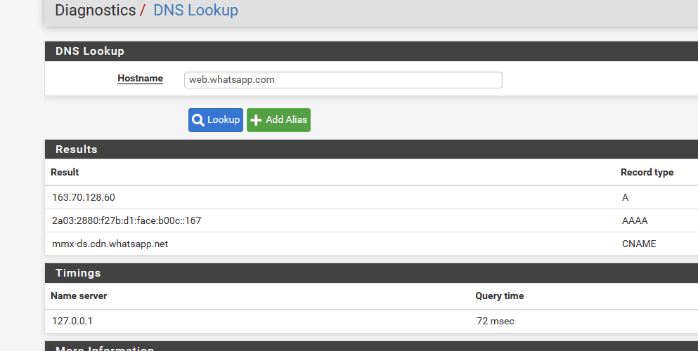

                JohnDow @Gertjan
                  JohnDow @Gertjan
                  Shell Output - dig web.whatsapp.com
                  ;; communications error to 127.0.0.1#53: timed out
                  ; <<>> DiG 9.18.19 <<>> web.whatsapp.com
                  ;; global options: +cmd
                  ;; Got answer:
                  ;; ->>HEADER<<- opcode: QUERY, status: NOERROR, id: 1471
                  ;; flags: qr rd ra; QUERY: 1, ANSWER: 2, AUTHORITY: 0, ADDITIONAL: 1
                  ;; OPT PSEUDOSECTION:
                  ;; QUESTION SECTION:
                  ;web.whatsapp.com. IN A
                  ;; ANSWER SECTION:
                  web.whatsapp.com. 37 IN CNAME mmx-ds.cdn.whatsapp.net.
                  mmx-ds.cdn.whatsapp.net. 38 IN A 157.240.0.60
                  ;; Query time: 18 msec
                  ;; SERVER: 77.88.8.8#53(77.88.8.8) (UDP)
                  ;; WHEN: Wed Dec 06 16:57:20 MSK 2023
                  ;; MSG SIZE rcvd: 98
                  Shell Output - dig @8.8.8.8 web.whatsapp.com +short
                  157.240.205.60
                  S GertjanG 2 Replies Last reply Reply Quote 0

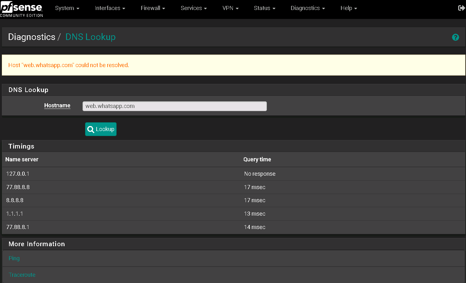

                    SteveITS Galactic Empire @JohnDow
                    So as noted is unbound (DNS Resolver) running? Check Status/DNS Resolver and the icons at the top bar.
                    In System/General Setup to what is "DNS Resolution Behavior" set?
                    To upgrade, select your branch in System/Update/Update Settings.
                    Upvote 👍 helpful posts!
